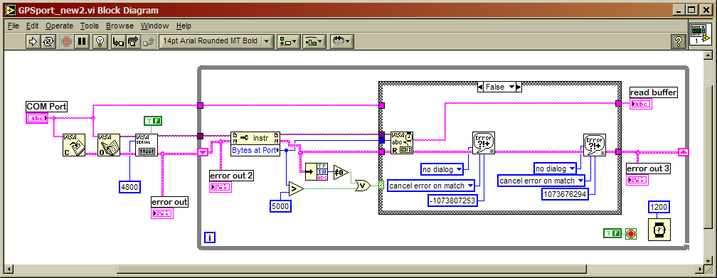

Sorry for the delay in responding but life got in the way.
The 1.6GB number returned is indeed a reliable indication of a disconnect.  I have reworked the code and it reliably detects a disconnect, and then tries a reconnect every loop until the USB device is found again at reconnect.  It doesn't open, close, or init the port otherwise except at startup of the app.
I added two error traps: one since the data reads are asynchronous to the source which ocasionally give a framing error on read; two since the buffer can ocasionally have more data than the bytes at port indicates, again because of the asynchronous nature of the reads.  The code graphic and the vi are included.
BIG thank you for all comments and inputs.  They were a great help.
