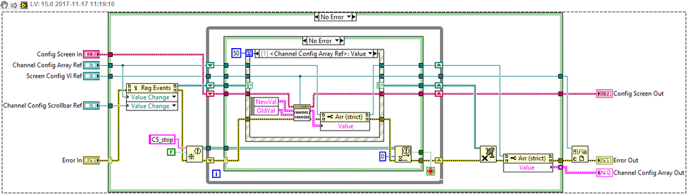

Here are the captured screens:

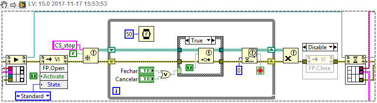

Main VI's loop.Main VI's loop.

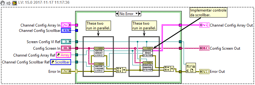

The sub-VI that loads the two VIs with their own loops..The sub-VI that loads the two VIs with their own loops..

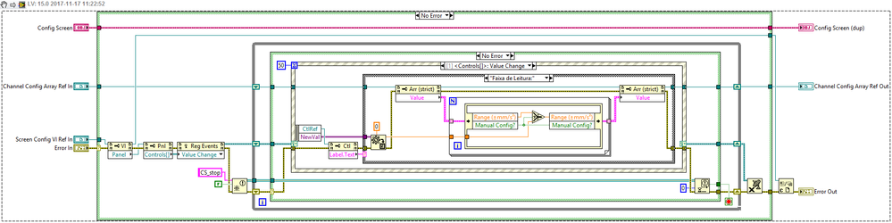

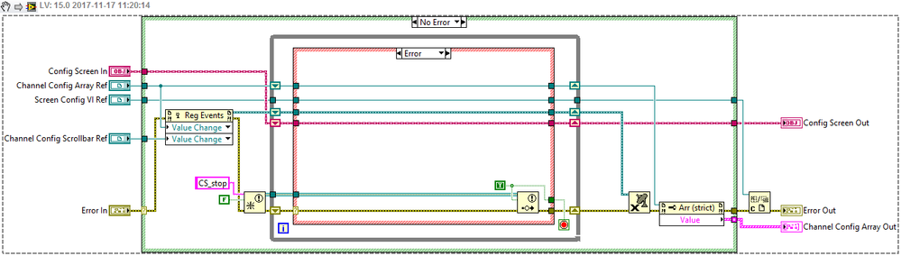

The 2nd loop (No Error view)The 2nd loop (No Error view) The 2nd loop (Error view)The 2nd loop (Error view)

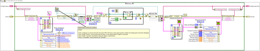

 The 3rd loop (No Error view)The 3rd loop (No Error view)

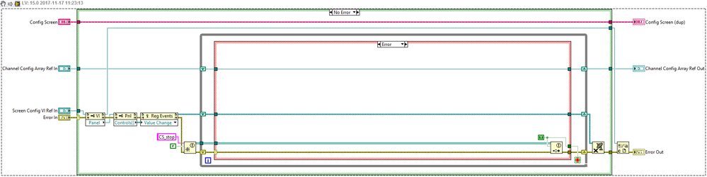

 The 3rd loop (Error view)The 3rd loop (Error view)

The resolution of the first image is very low, so I cannot see your "main loop".
Here's a zoomed-in version. It's very simple right now, just a skeleton for future functionality:
Main loop zoomed in.Main loop zoomed in.

Accepted by topic author alexgieg
I changed my VIs to User Events. And they didn't work either. The behavior was the same. So I began messing around and discovered what the issue was. It turns out that "Generate User Event" (and probably "Send Notification" too, but I haven't tested) doesn't generate the event if its error input receives the error you're trying to generate an event about. End result: unwiring the error input from the icon, and using a Merge Errors afterwards, did the trick.
This was a quite silly bug, but I liked learning about User Events, and I will start using them way more than before. Thanks for your suggestions then! They both provided me new knowledge, and pointed me in the right direction!

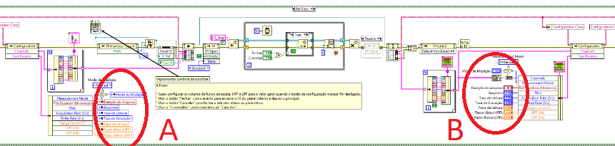

Of course you have a glaring race condition on your toplevel.
Your controls (B) will get read immediately as the outer case structure starts and we don't know if the locals (A) are written before or after that happens. Classic race condition! More importantly, if you change any of these controls while the inner while loop is spinning, their new value will not get read again by the code until the next time this VI executes. Most likely the code will operate on stale values most of the time.
Even if you think it does not matter here, I would fix that to avoid surprises in the future.
