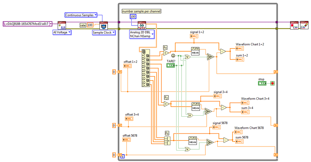

I'm sorry for late response in this few days.
Honestly, I need to acquire 8 channel input data. Which is there is summing operation.
ch 1 + ch 2 = Fx
ch 3 + ch 4 = Fy
ch 5 + ch 6 + ch 7 + ch 8 = Fz.
I've made a program for this case (vi attached). Would you guys mind to check my .vi file to make sure this 'tare function' to zero-ing the averaged value each summing operation?
Thank you.
Thank you.
That looks very reasonable.  I would suspect the UX might be a little "Flakey" since the user must decide when no load is applied and Tare at that point (and woe to the user that presses start with a load applied) but the operation is correct
