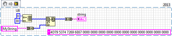

One more suggestion (which I think is simpler than the above proposals): convert to a byte array, reshape the array, convert back to string. String to Byte Array, and vice versa, are free operations - they do not allocate memory buffers or make data copies.
EDIT: before someone points this out, yes, this only pads with nulls. If you need to pad with some other character, use on of the other suggestions.
