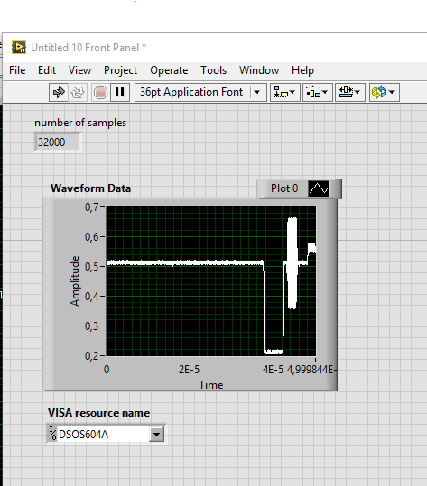

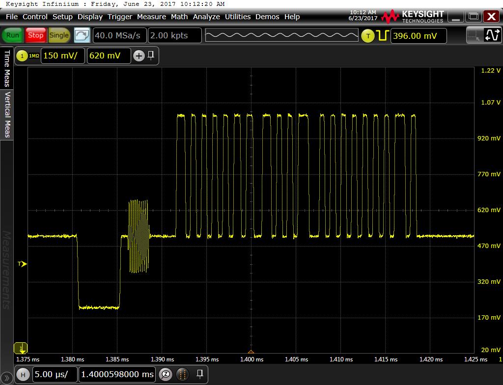

I have set my scope to 40Ms/s and a time span of 50uS resulting in a expected 2kpts waveform on the screen.
When I then get the waveform with labview I got 32kpts. I don't understand why.

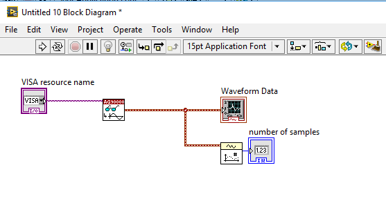

I would imagine that it gets set in the Read Waveform vi that was not attached.  32K just so happens to be the max value of an I16 (+32767).

The vi was attached to the scope.
I got the answer from someone in the labview community. The scope interpolate the extra point by default. When I switched interpolation off I got the expected 2k points.
(:ACQuire:INTerpolate off)
