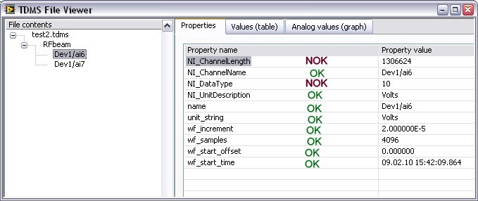

Hello!
I dont't get the property value NI_ChannelLength and NI_DataType from a tdms file using the 'TDMS Get  Properties' vi.
All other properties are returned.
Inputs to  TDMS Get Properties: GroupName: RFbeam; ChannelName: Dev1/ai6.
Output: Variant on output 'property value' (wiring I64 to datatype input does not solve the problem.
These properties are displayed in the TDMS File Viewer however. I marked the missing props with NOK:
What am I missing? Thanks for tips!
Klaus
Message Edited by Klaus M on 02-09-2010 10:56 AM
Message 7 of 11
(7,781 Views)
This is weird in that the TDMS File Viewer does exactly that ("TDMS Get Properties" wired with group and channel name, but no property name or type). You might want to look at the "File Contents: Value Change" event in "TDMS - File Viewer.vi" and double-check that your code does the same thing.
