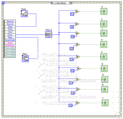

Ok and so this is what the event should look like? Obviously minus the LEDs in there
The Event structure should be inside a While loop, and I'd use a case structure instead of lots of separate Equals comparisons. Without the LEDs and comparisons there's almost nothing inside that event structure, so I'm not sure what you're asking. It would be more helpful to show the entire program, since I still don't see a shift register anywhere (due to the lack of a while loop).

Still getting my head around how the overall layout of the program will look like. Going to work through what you have suggested tomorrow and see how I get on.
