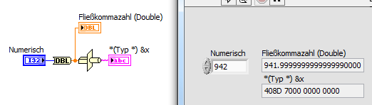

After entering 0.002 in to a numeric control of the double type, the indicator of the same type with 20 digits of precision shows a value of 0,00200000000000000004. And the result of 2 / 1000 is also 0,00200000000000000004. It is not possible to calculate or compare anything with this type of hidden deviations. I also found another comment where a conversion of an INT to DOUBLE had the same result, a deviation of the mathimatical correct valeu. INT 942 converterd to a DOUBLE becomes 941,999999999999999. Is this a bug in labview?

the only buggy part is the display of the 942 converted from I32 to DBL!
But it's just a bug in the display of that value, it's no bug in the underlying data:
The typecasted string contains too many zeros to hold any fractional part in this DBL value!

Inaccurate is representation of numbers using floating point format.
When number of digits to show is above precision (~15 for double), display can pick any value that is represented with received sequence of bits. He picks 941.9999... . This number for him does not differ from 942.
Do not use displays with precision of more digits that your number has.
