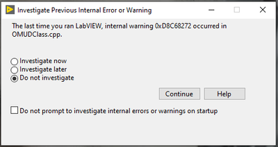

I dont know how, but now my labview code is giving me this error.
Basically any ideas? 🙂
When I click "Investigate now" it generates a error-log, with this informations:

DWarns aren't something to necessarily be concerned about (I think you can go into Tools>Options>Environment to simply ignore this prompt).
When do you receive this error (I'm guessing it's either on LabVIEW open or close)? If I remember correctly, OMUDClass generally deals with loading LabVIEW classes so you may want to try mass compiling the Modbus library source files to start.
I get the error when I starting up Labview, yes 🙂
How to "mass compiling"? 🙂
(2,289 Views)
Tools > Advanced > Mass Compile. You'll need to select a folder which will probably be either "<LabVIEW>\vi.lib\Modbus" or "<LabVIEW>\vi.lib\NI\Modbus Library".
