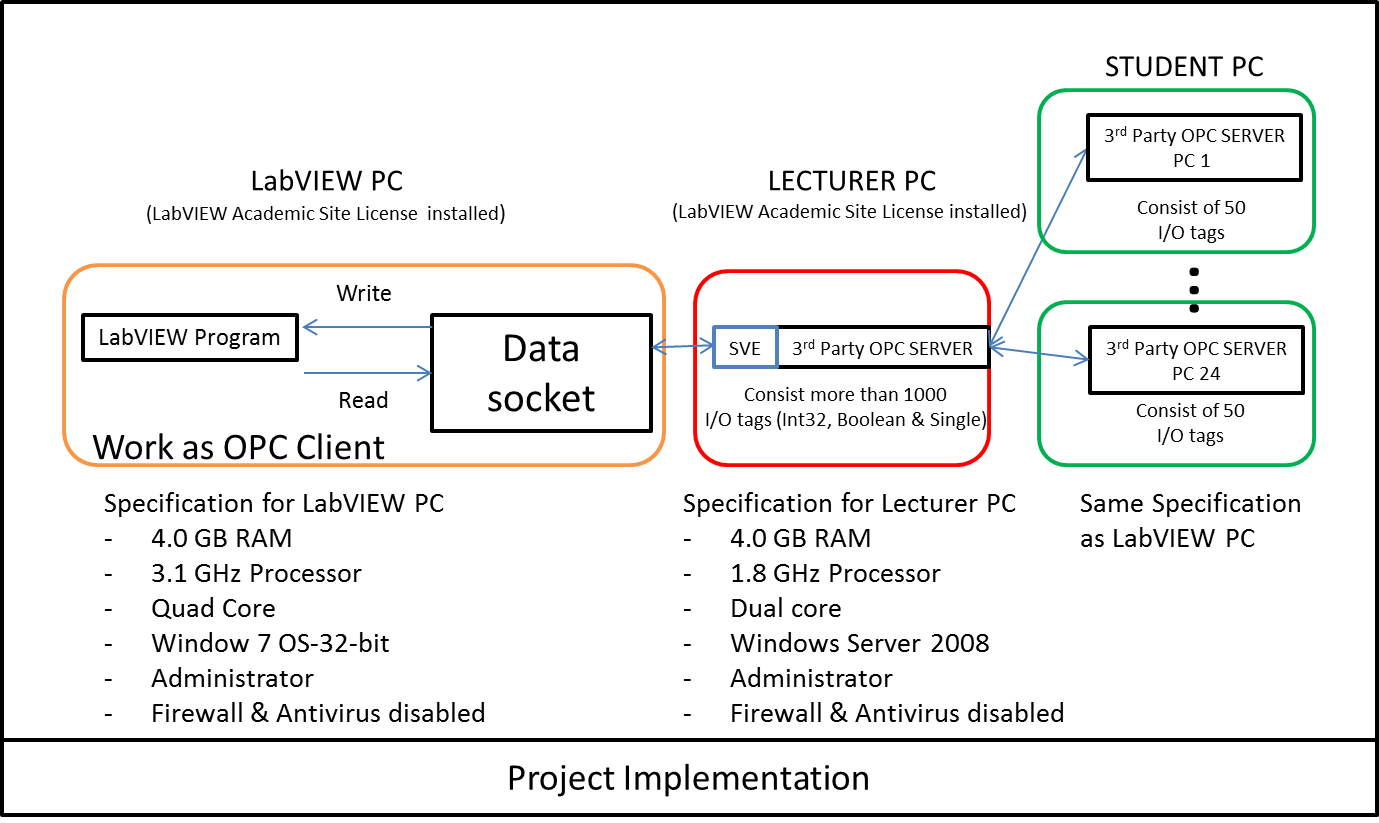

3 types of PCs were setup in a training labarotary which are LabVIEW PC, lecturer PC and Student PC. At LabVIEW PC, We’d developed a LabVIEW program to work as an OPC Client to 3rd Party OPC Server, Yokogawa Centum. Since the communication to this 3rd party server is not very straight forward, DataSocket was implemented as it allows easy data transfer over many different protocols.
At lecturer PC, we’d deployed network-published shared variables to a shared variable engine (SVE) that hosts the shared variable values on the network. The SVE works as server for a shared variable and all the references (IO tags from Yokogawa Centum) are the clients.
SVE at Lecturer PC published the 3rd party IO tags meanwhile DataSocket at LabVIEW PC subscribes it. The OPC Server will response to the feedback from LabVIEW program via DataSocket and distributes the signal to 24 Student PCs IO tags accordingly.

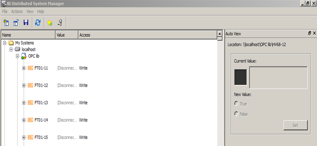

LabVIEW software unable to deploy more than 500 I/O. When more than 500 I/O deployment has done, issues occur such like all the tag will crashed and disconnected from the 3rd Party OPC Server (refer to Distributed System Manager screenshot).DSM error.png Even though we find out we need to wait for around 45 minutes in order to complete the connection (during this period all the I/O is  not connected) but we still  encounter other issues like  LabVIEW unable to WRITE data into our OPC.
