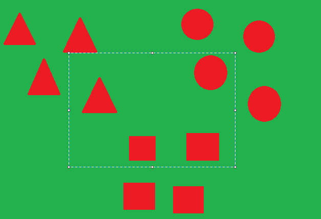

Could please help me in Classification of objecets? My project to classify the objects in  ROI. For example in the below fig ROI contains 1 triangle, 2 Squares and 1 Circle. In the output it has to show TriangleClass Sample 1, SquareClass Sample 2 and CircleClass Sample 1.

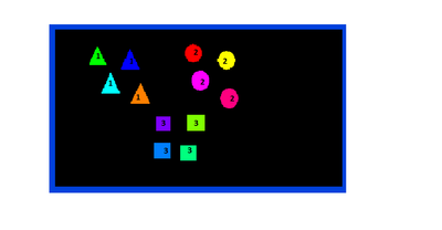

My project is Pattern Recogonisation (Image Processing)
For this, I did Image Acquisition , Segmentation and Feature Extraction.. Now I have to do the final step clasification.
I need output asClassification.pngafter classification(with 3 diff classes ). I don know how to train the Image to get output as above.

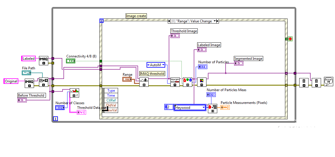

Thanks fot the reply Phil_. I saw that example.Ya it was related to my question. I am very new to Labview so not able to understand that code. Am attachting my code. If possible,please, can anyone add the classification part to this code.Image.png
Message 8 of 15
(9,558 Views)
Sorry, I am no more familliar with the classification VIs than you (neither am I in the business of doing peoples homework for them Smiley Wink .)
I would persevere with that example, use the help files to figure out how it all works and then try implementing it yourself.
(use the context help tool, then click 'more details' to dig deeper into the subject).
Have a bit of a google, see if you can find a manual for it online. (I had a quick look, but didnt see anything)
Good Luck. Stick with it.
