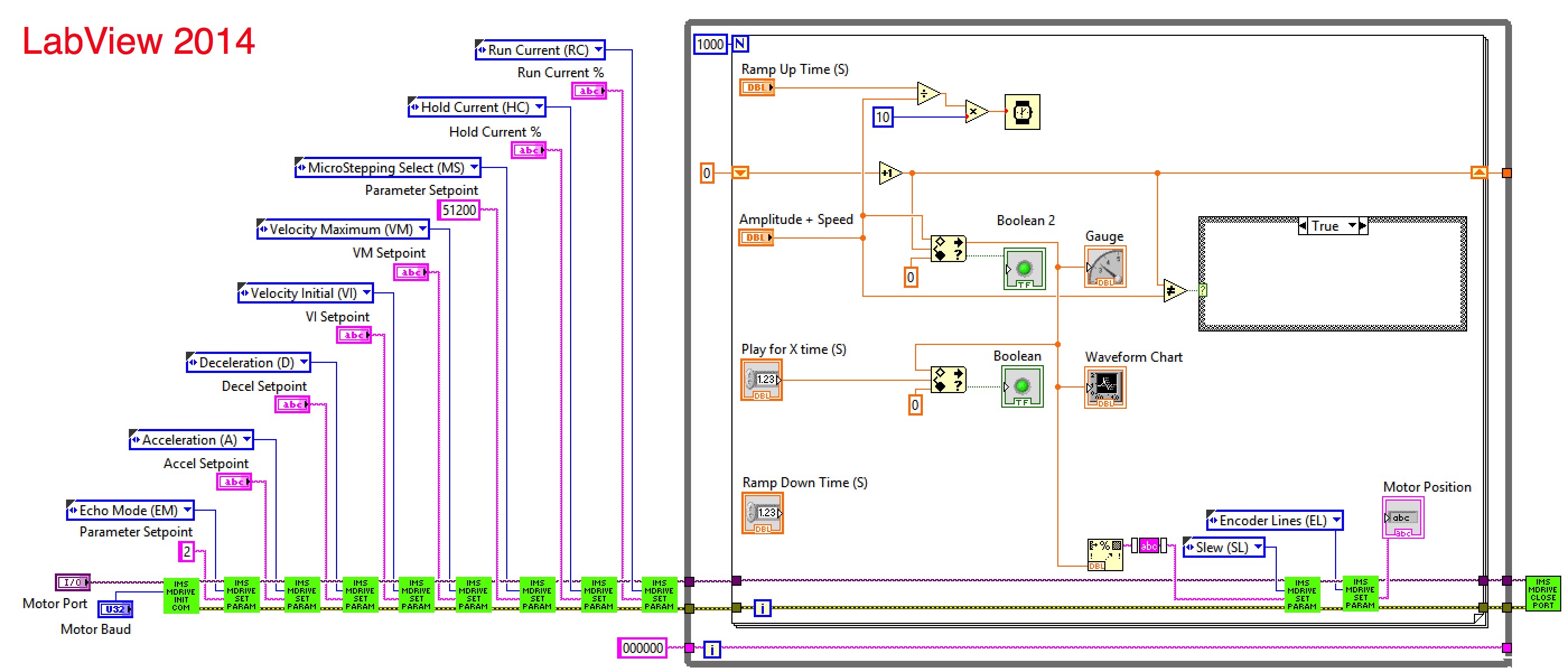

I am learning stuff!

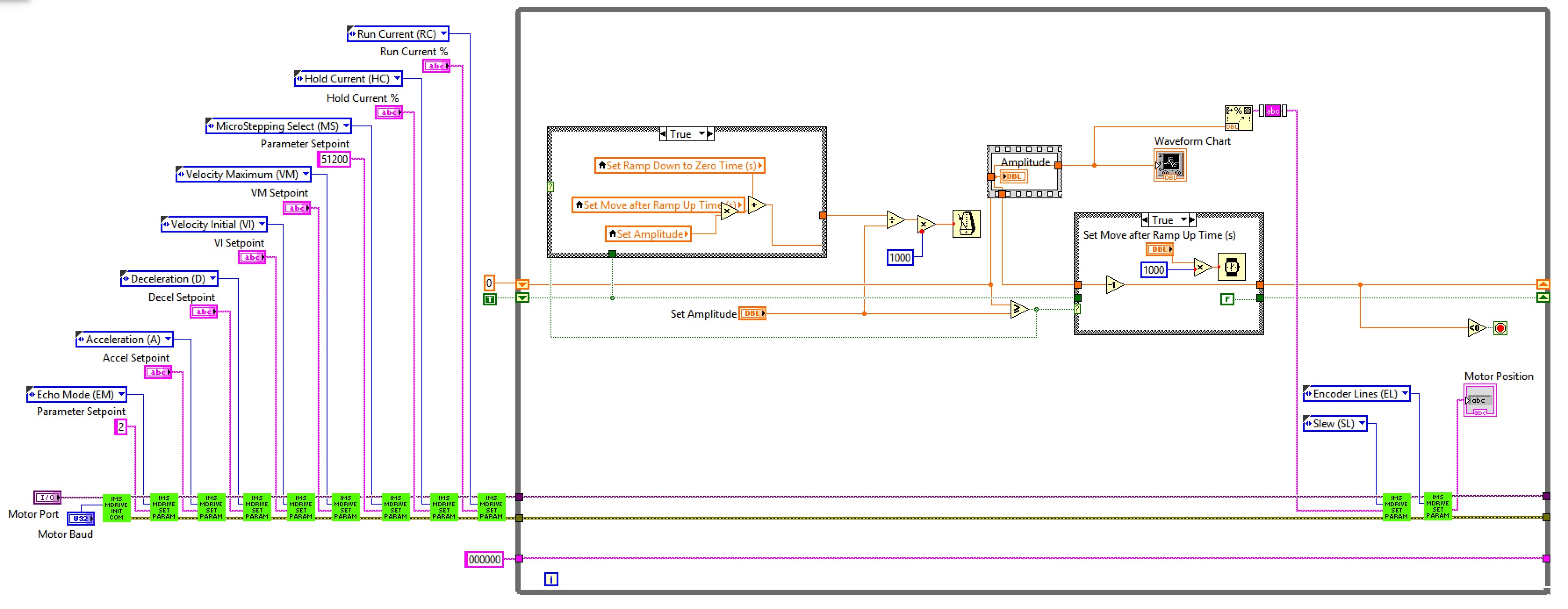

This is where I am with the project. Big project for me ;o)
I'm breaking it down to a few parts to help me learn each.
1) Motor
2) Ramp Up
3) Amplitude up to full speed
4) The Pre Wait Time
5) Motor Position from Motor
6) Play/Move Time after Ramp  Up
7)  Ramp Down to Zero Time
The VI is split like this:
The Green boxes are working, the Red box is what I'm working on now and the Blue box is next.

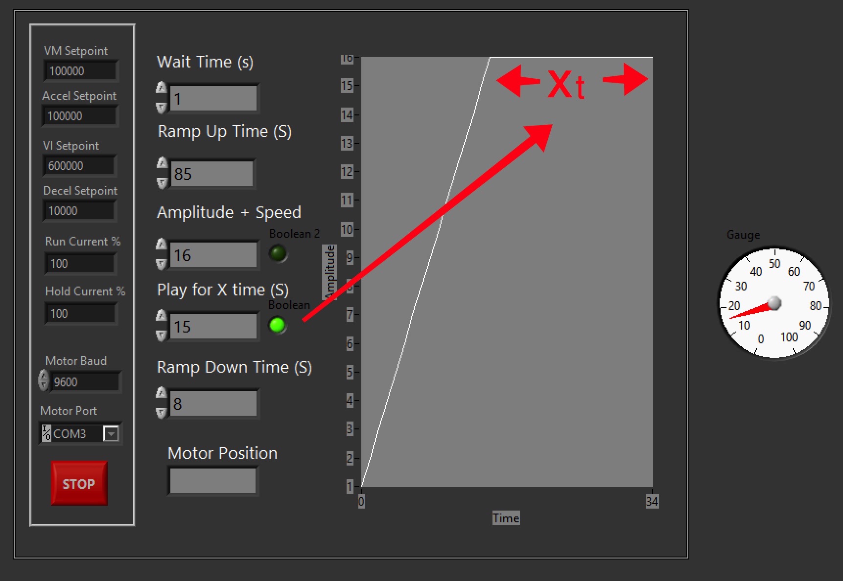

My new task is to get the: Play for X Time after the Ramp Up as been achieved. Then start the Ramp Down. The Ramp Up is working!
Like this:
6 on the VI image above.
I have changed everything else that was suggested in previous posts.
I will attach the VI, just in case, it helps others. I like it when I can grab a VI and us it from other posts.
Please continue to teach and help, you Guys are helping a lot!
Many thanks,
Mike

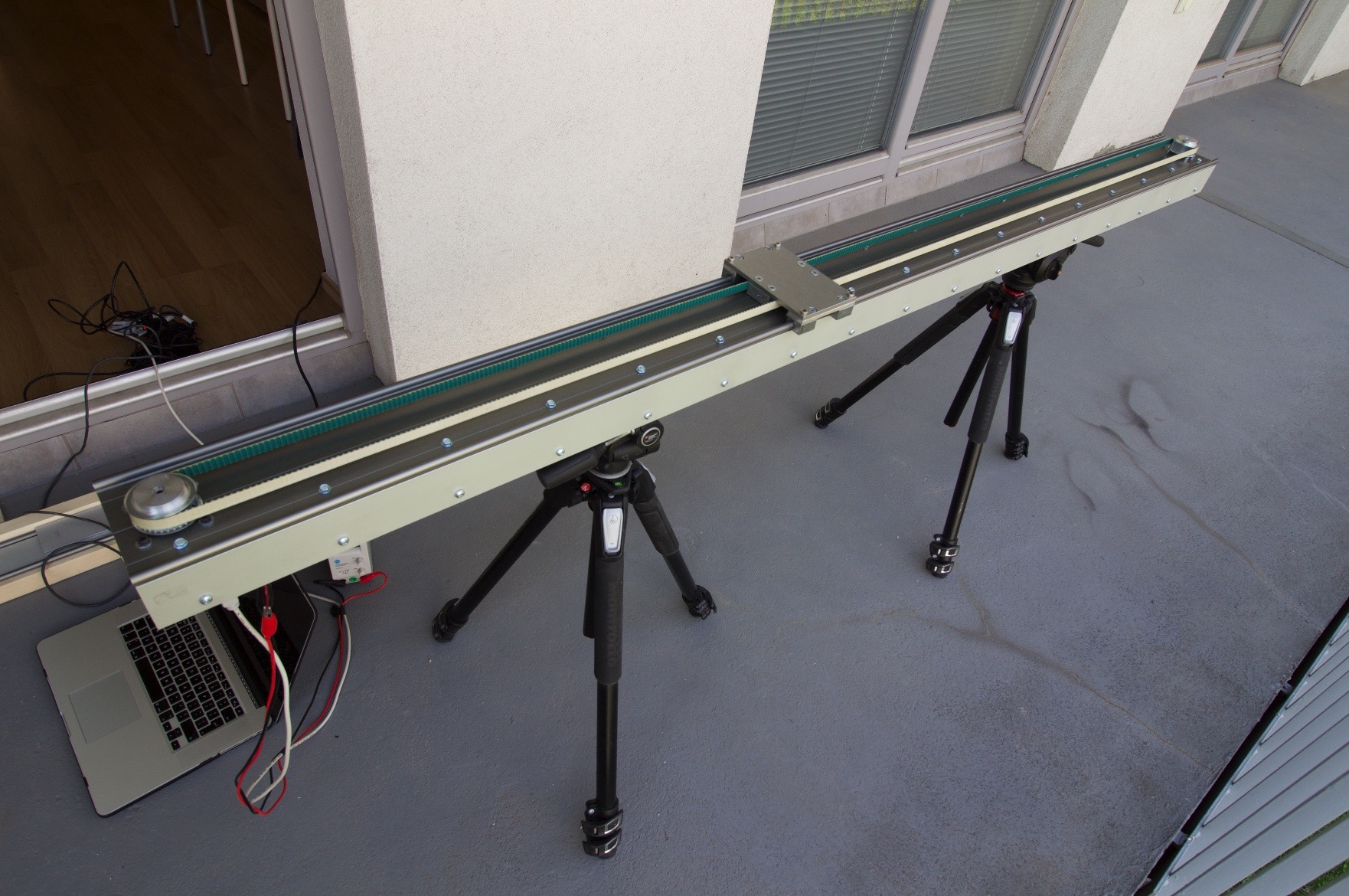

This is the Rig - First Axis:

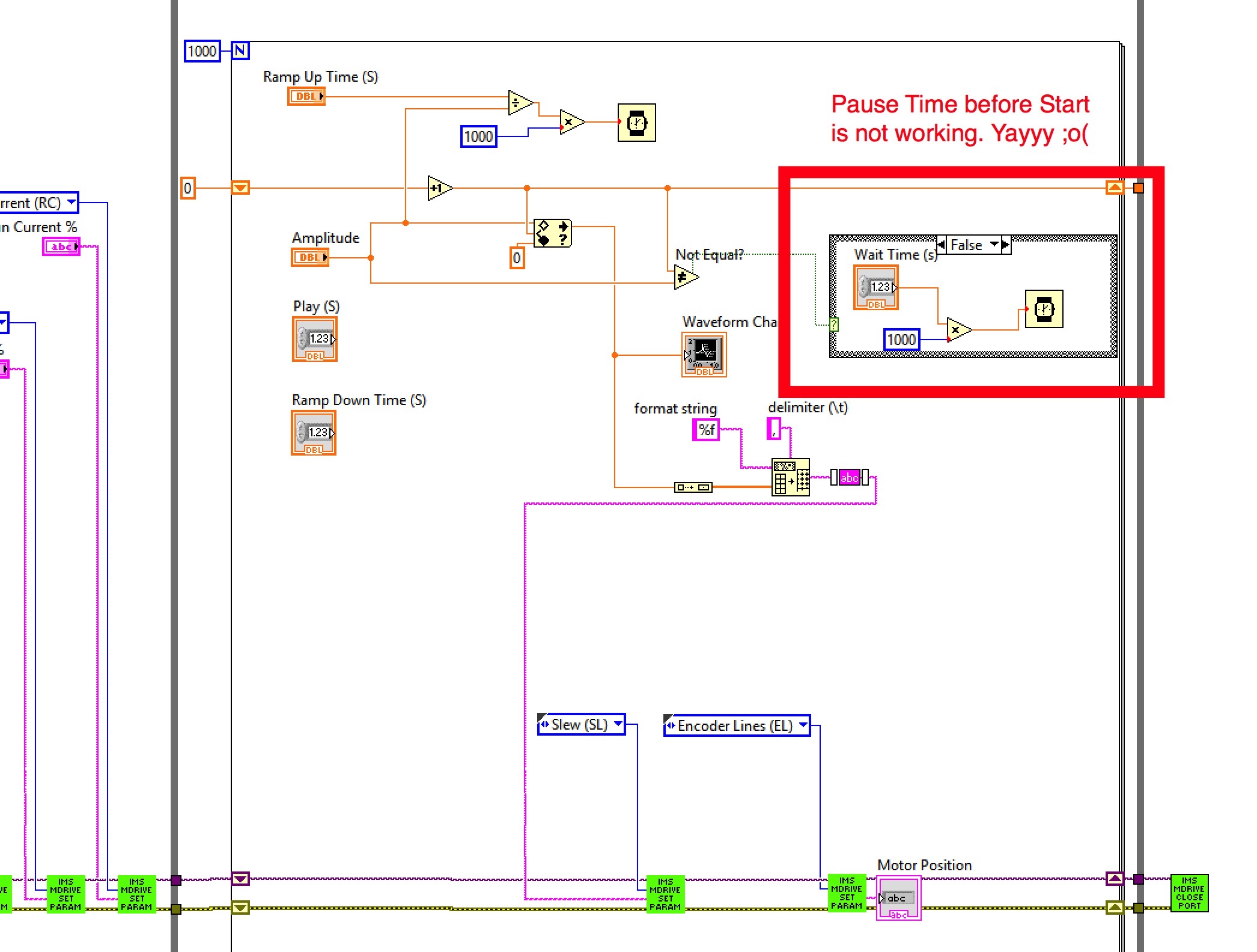

Trying to get the pause before starting working again.
Message 25 of 26
(1,066 Views)

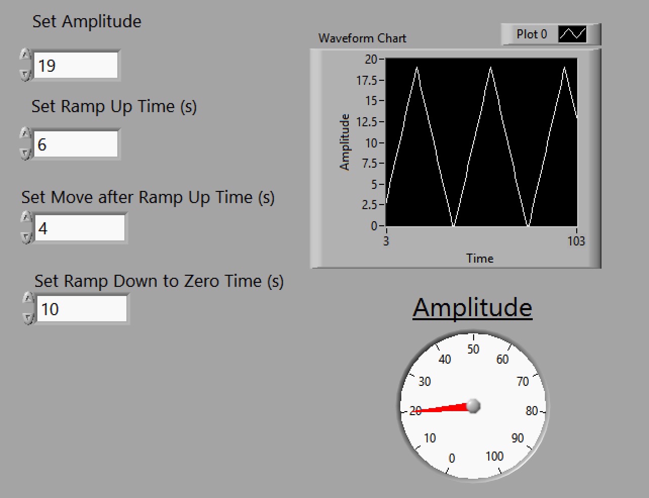

Busy morning and an all new direction after lots of study and searching.
This does exactly what I wanted. Very controllable and smooth.
I will attach the .VI to help others.
Want to make it look better.
