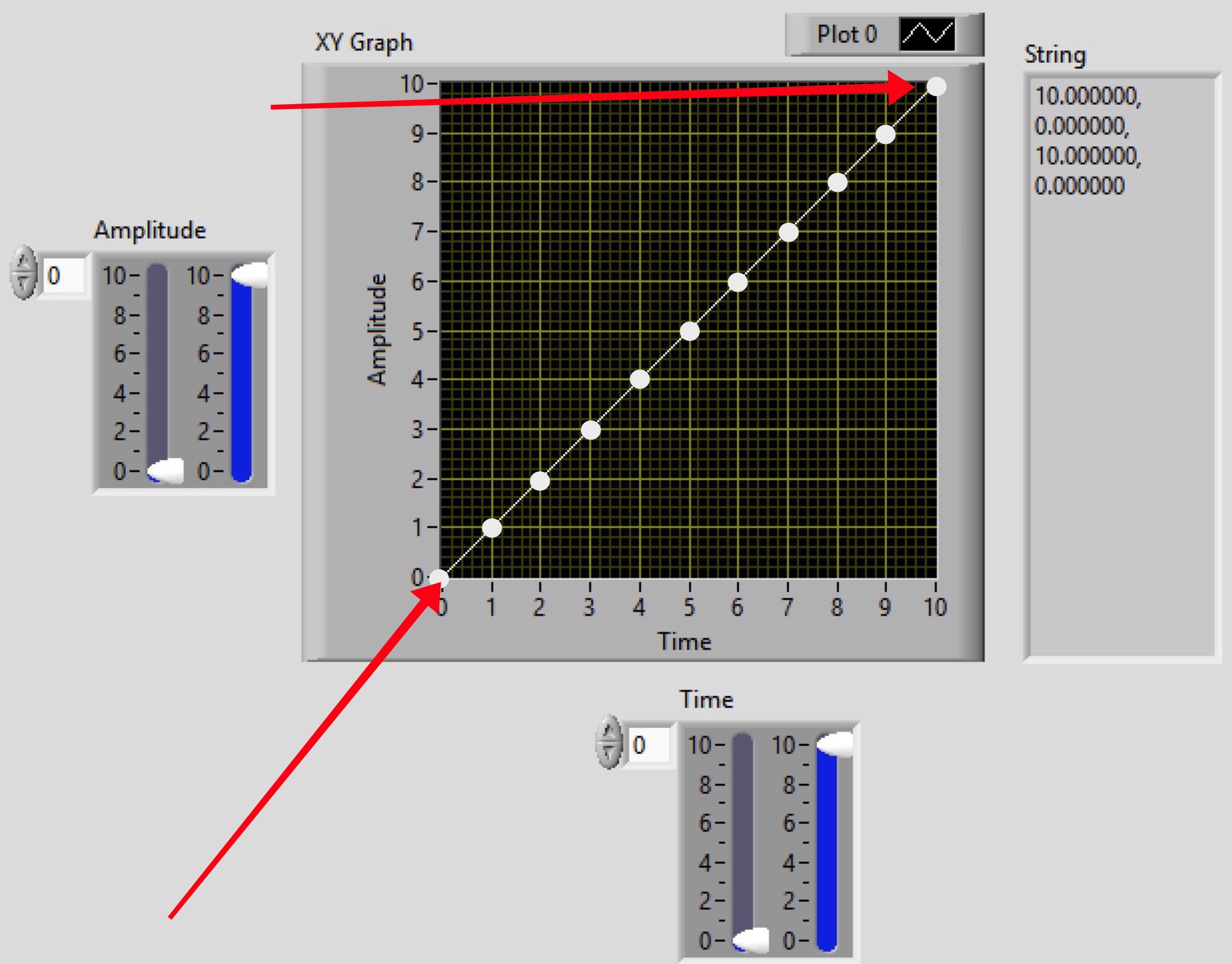

This is what I'm trying to do.

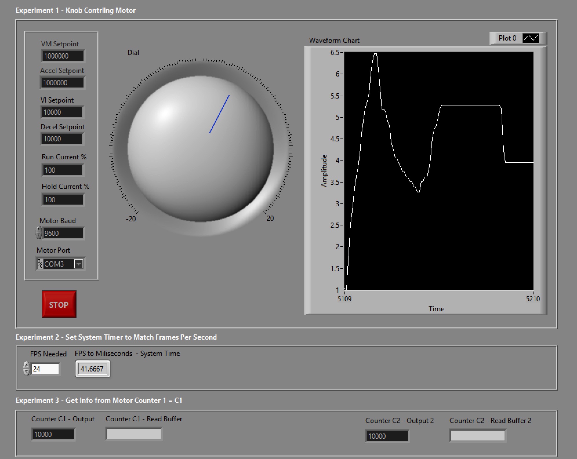

I have a camera slider and it works well when I control it with a LabView Knob. Like this:
The data is the Dial/Knob creating a string to an Arrey (As above) The data from this goes to the Slew (SL) of the stepper motor and it ramps up, moves and ramps down.
I want to replace this with a better system, more accurate.

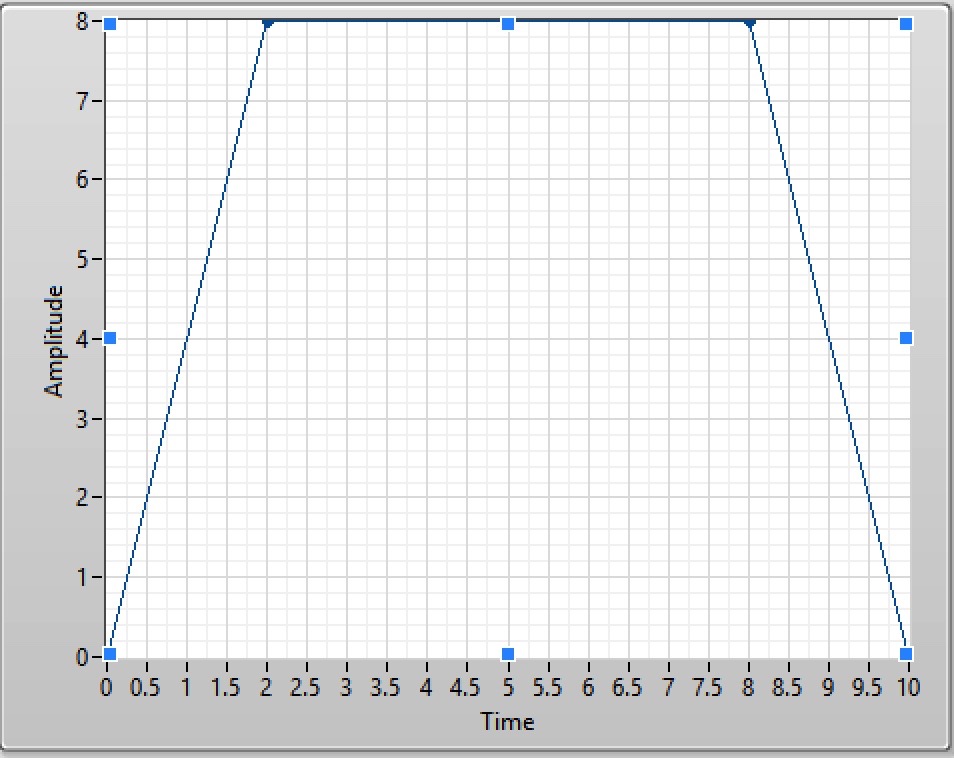

I want to replace the Knob with an ajustible slider systen with Ramp Up - Move and Ramp Down.
Like this.
I want the operator to be able to move the four points and the system output data that controls the stepper motor like the Knob.
This is why I'm trying to create the data between the dots.
The dots are the operators control, the data would control the stepper motor.
Or am I just crazy ;o)

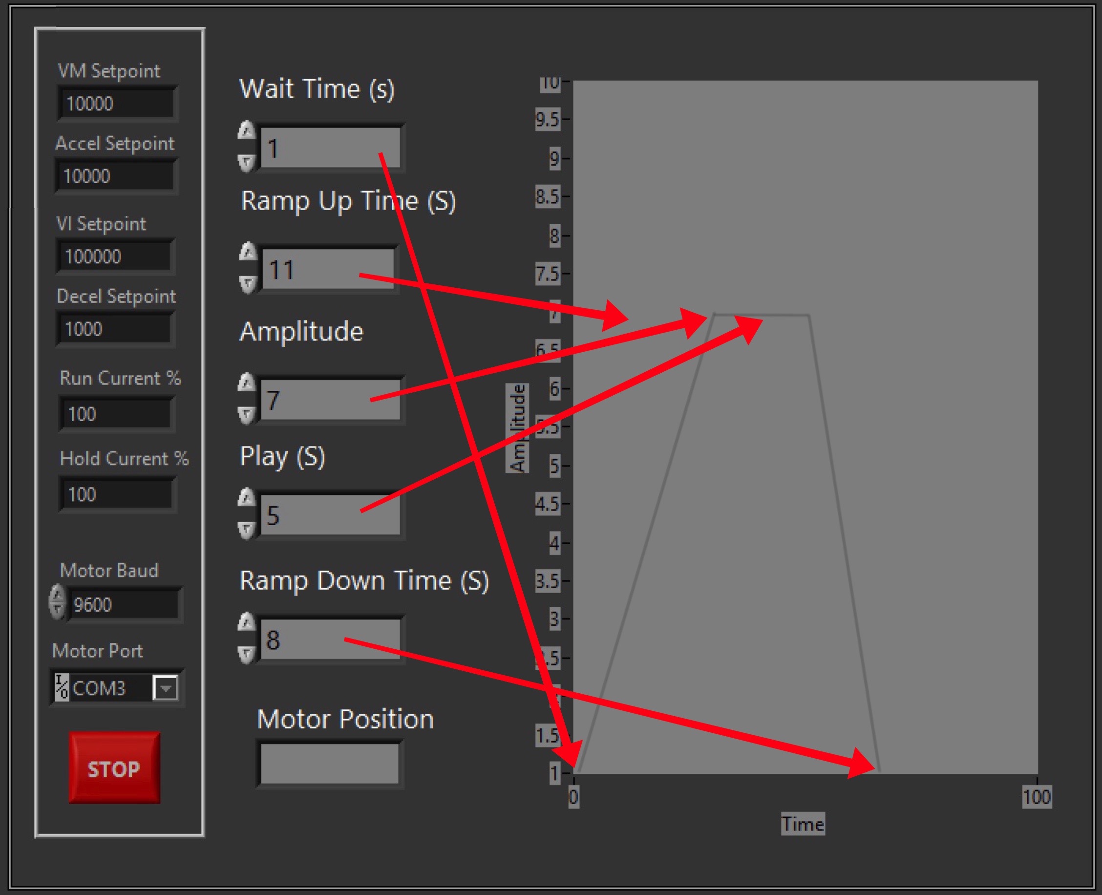

A lot of investigation and I'm now on a new path.
I found a ramp up current over time.VI on this wonderful Forum!
I started to use parts and thighs have started to work.
I think this is a much better result and option!
I re-made the Front Panel:
Wait Time
Ramp Up Time
How Fast - Amplitude
How long to Play before Ramp Down
Ramp Down

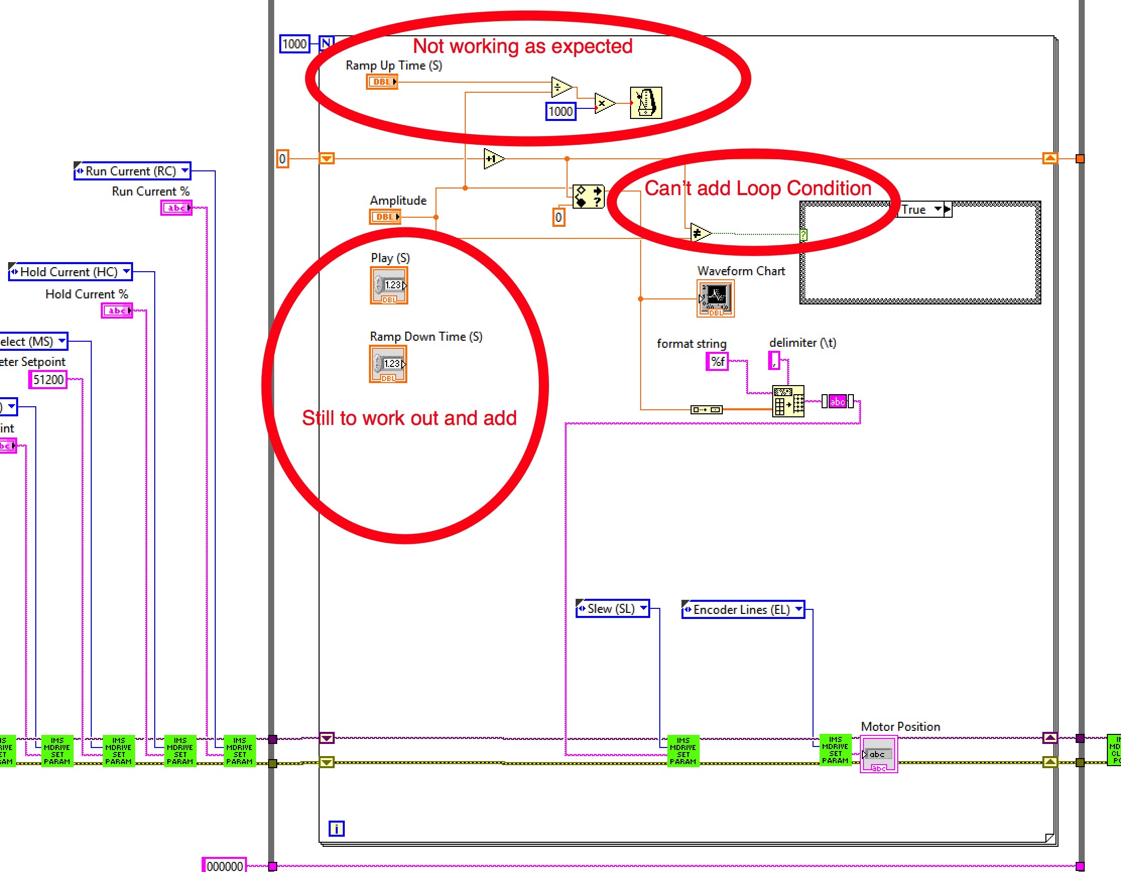

Not all is well on the Dark Side:
The timer has stopped working, I think this is due to my lack of skills adding the Loop Condition - Saying Loop if True
I still need to work out how I get it to play for X'seconds before Ramping Down for X'seconds to Zero and stop.

Looks crazy, but I'm trying to do this and send the info to the Slew of a Stepper Motor.
Message 18 of 26
(1,633 Views)

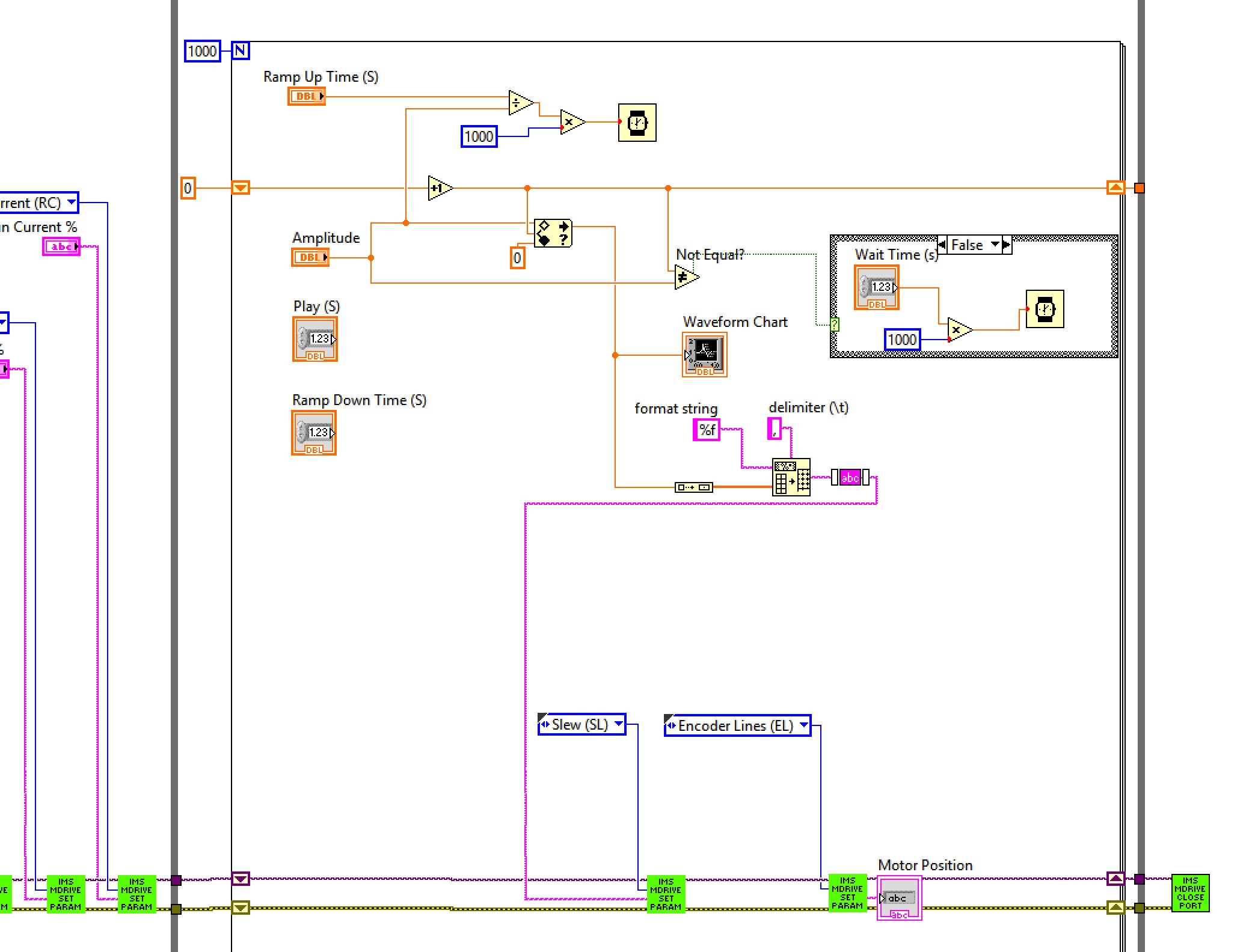

Like this!
I see what you are saying now.
Message 19 of 26
(1,630 Views)
Two recommendations...
On the string palette >>> Number/string conversion
You can find functions to covert numbers to strings. That will let you get rid of the format as spreadsheet... construct and wire directly to the slew sub-VI.
