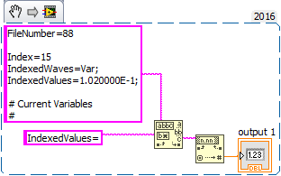

I have one more issue.  I am attaching an image of just a snippit of code not working right.  When I run this I get error code 85 that the input string does not contain data in the expected format, even though this works if I get rid of the rest of the text and only have the line IndexedValues =1.0002E-4
Message 14 of 15
(1,118 Views)
Again like in Message 6 - Use the Match Pattern.
Match Pattern.pngYou are not handling all of the information before your search string.  Using the Match pattern will lump all of the data prior to the match under output a.  If the data will sometimes have a space before the numeric value, add a Trim Whitespace after output c of the match pattern.
