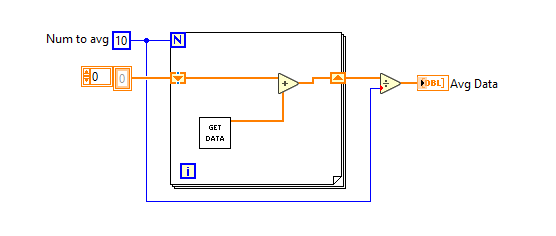

For averaging, I just collect the data (spectra in this case) in a for loop, each time adding the data arrays together and then dividing by the number of loops afterward.

Here is an example of averaging:
