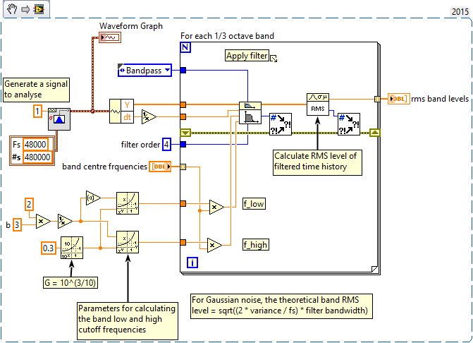

For each filtered version of the signal, you just need some measure of the average energy.  I usually use the RMS level because it's fairly standard in my line of work.
Andy
