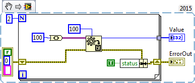

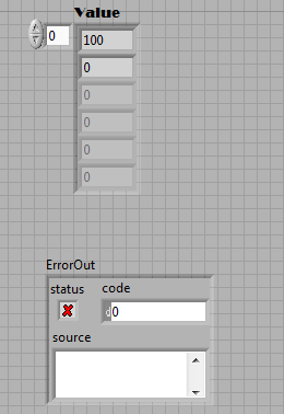

I ran into an unexpected result when using "Variant to Data" vi. As I understand, the Variant to Data vi will output the default value of data type wired in "type" terminal when an error occurred before this vi. With this understanding, I think the output result of following vi is an array with element "100" and "0".
However, I got an unexpected array with element "100" and "100" (LabVIEW 2014). It seems like that the "Variant to Data" vi output the result of previous successful execution when an error exists in "error in" terminal.
  Is there something I misunderstand about "Variant to Data" vi??

Tried the same in 2015 i am getting 100,0

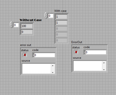

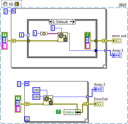

Found the same issue when using Case.
Without case structure it gives proper result.

Hello Bob,
Same Functionality when addressing in different ways (with and without case structure gives different output)

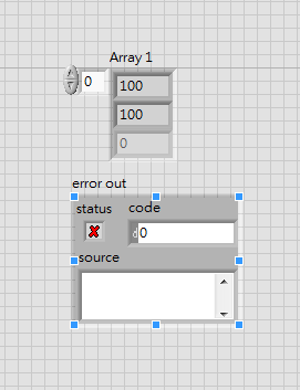

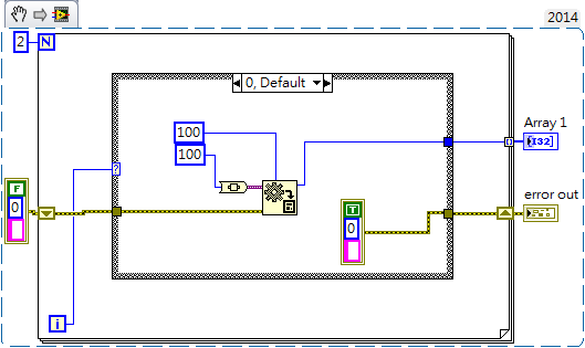

Reproduced in 2016, but not in 2018.
I want to say that this issue was discussed in a private board.  The issue there was specific to classes, but it was acting similar to this.  I think the issue was fixed in either 2017 SP1 or 2018.
