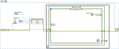

Example code for adding Office 2007 Ribbon to LabVIEW Front panel. For details see blog post from Simon in the UI Interest Group Community.
--Karsten

Thanks for posting the VI KvZ.
How/where do we get the RibbonControlsLibrary.dll?
Message 25 of 26
(4,048 Views)
battler,
Check out this thread for the RibbonControlsLibrary.dll link:
http://decibel.ni.com/content/groups/ui/blog/2009/11/10/creating-an-office-2007-like-ribbon-in-labvi...
Matt
