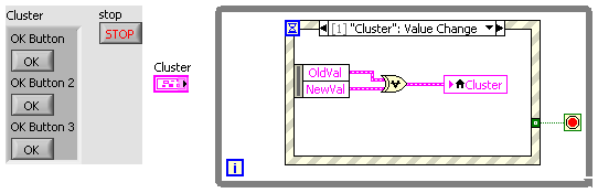

Radio buttons.
Another option would be to handle the value change of a button in an event structure, and change the value of the other buttons back to false programmatically. within the event case.

It is not clear from your image which buttons are mutually exclusive (naming them all "cancel button xxx" does not really help to improve clarity).
Do you want each row or each column to be mutually exclusive or do you want only one of the 16 buttons on at any given time?
A radiobutton control is just a specialized container, similar to a cluster. You can drop or remove as many boolean buttons of any shape (except it unfortunately cannot be empty, that's why we have this idea) and the code will do the rest. You should be able to figure it out easily. In your case, you would drag the desired buttons from your front panel into the rabiobutton control, then delete the booleans that were already in there. The value of the radiobutton control is similar to an enum, with the item name corresponding to the button labels.

@cpalha wrote:
...About other option, can you please do a smal example 2 or 3 buttons?
Thanks in advance.
cpalha
set the controls, "switch when pressed"....
