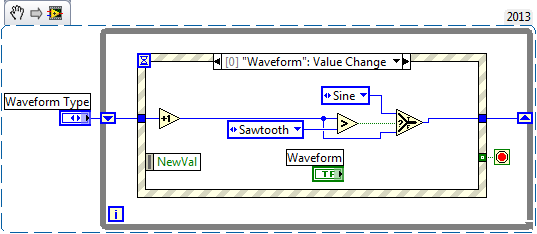

You need to use the Boolean as a toggle that will step to a different waveform each time it's pressed.
Something like this:
Of course, this is an example that needs a lot of work.
Kelly Bersch
Certified LabVIEW Developer
Kudos are always welcome
Message 3 of 19
(3,447 Views)

Don't forget to type def that enum!
Yeah, I meant it when I said it needs work.  The enum needs to be a type def and this really should feed a producer/consumer or something like that.  I just threw that togeather to give the OP a starting point.
Kelly Bersch
Message 5 of 19

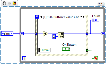

i was thinking.....
Message 6 of 19
(3,420 Views)
That works, too, except there are four waveform types not three (Sine, Square, Triangle, Sawtooh) so the constant should be a 3 instead of a 2.  The concept is very good.
Kelly Bersch
Message 7 of 19
you got the jist of it....   Smiley Wink
actually, 4 waveforms (0,1,2,3)...constant should be 4

@apok wrote:
Guys... Ahem ... Constant?  P-Node Num.ElementsSmiley Wink
Go to it !
Message 9 of 19
(3,386 Views)
Constant should be the highest number we expect to see, which is 3 or number of elements -1, since the first element is value 0.
Kelly Bersch
Message 10 of 19
