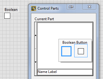

I can customize the 2D Picture control and I have access to the part named "Frame".
However I did not manage to extract the frame of the Classic Boolean Flat Square Button, when I customize it I have only one part.
LabVIEW 2016
Message 4 of 11
(5,529 Views)
Bob,
I was having a similar problem (the customize option was greyed for me...in the advanced submenu) until I realized that the customize window was already opened for another control.  Apparently you can only customize one control at a time.
awilliotAcutronic,
Yes there are only two parts on the flat boolean and that is the part that you want to use.  I've attached my version of the control.  You may need to play with the dimensions of the Picture Area part because it is currently sized for a thicker border.  With a 1px border in the same location, there is a small 3-5px white "margin" around the control where you can't draw anything.  You can see it in the upper left corner of this screenshot.
