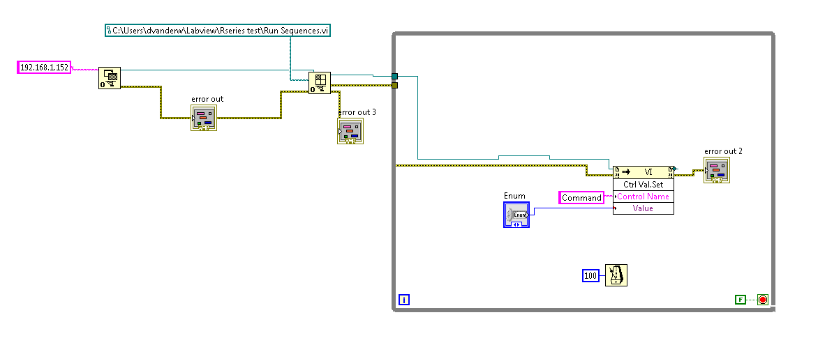

I am writing a DAQ system (science) and I want to connect to VIs in the Main Program through "Open VI Reference". It works very well while I am on the same computer. However, when I try to do the same thing from another computer it does not work.
Generally the idea is to change some values in the Main Program from VIs on other computers. Attached you will find two VIs which I use to connect to the Main Program (only test.vi is important). When I change a value of "enum" it should change a value of "command" in the Main Program.
I have no errors. It even read the value of "Command" when I changed to "Ctrl Val. Get". However, it read it only once.
Also, when I write and read value of "Command" in test.vi I see change, but only in that .vi. I do not see any change in the Main Program.
Any ideas?

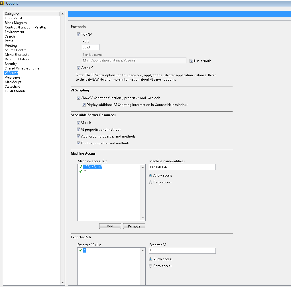

This is the scrren of VI Sercer. Properties in the Main Program are very similar (also a lot of "*" and the same things are checked).
Thank you in advance!

Did you set the VI server options in the project not just the default server?
Try to set the FP as open just to make sure that you are targeting the VI in the context you think it is running in. Could be its working but in the wrong context so you never see it.
Ben
