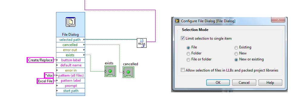

Then show the entire code, including the parts where you open the file. Please attach the VI!
So far, you only select the VI, the important issue is how you use the selected path later to open the file.

Here is the file... Please help

Show the code where you try to create a new file.

It can't be.  You don't have any code in there that tries to actually open a file, whether it already exists or not.  The only code related to files is the Express Dialog, and the subVI that tells you the extension of the filename picked from the file dialog.
