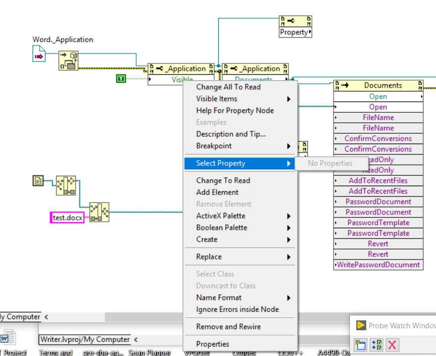

Also, when I try to look at the properties of a property node I get the following:
--> no properties
When I connect an activex property node I also get --> no properties, even though it clearly works in the online example.  I am using LabVIEW 2017.  I'm a bit lost.

Thanks Alexander,
I used the vi you posted to copy content -> text.
I found this link : https://knowledge.ni.com/KnowledgeArticleDetails?id=kA00Z0000019KZNSA2&l=en-IE
It appears I need to have LabVIEW 64 bit installed for it to allow me to access the 32 bit Word.  I had a similar issue with MySQL, so maybe there is a workaround but personally, I am now downloading 64 bit LabVIEW!
This is exactly opposite of what the link says.  The bitness must match.  Are you sure that you have 32bit Word installed?

Whoops, I meant 64 bit LabVIEW to access 64 bit word!
