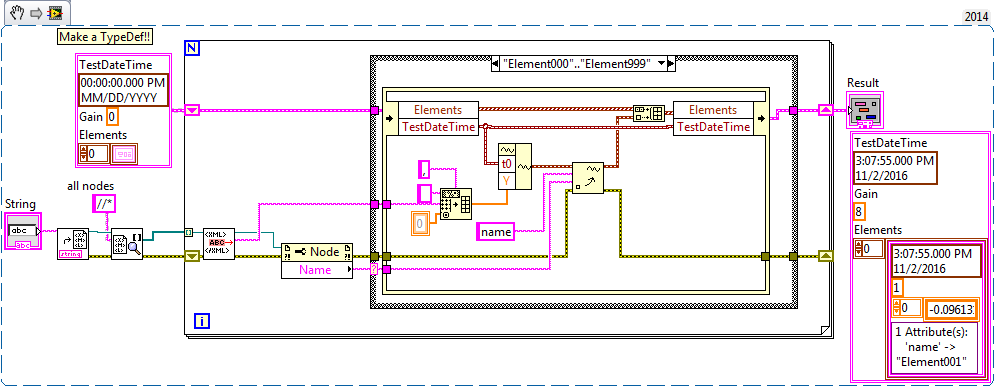

In your future XML adventures, remember that values like sequence number are better as attributes than part of the tag name, so you should have 32 Element tags with an index attribute of 1-32 instead of Element001..Element032 tags.  That ship has sailed on this project.
For a fixed schema and no desire to modify the XML I would simply start with a simple parsing VI that examines all nodes, decides by its name if it is interesting, and if so converts to the proper datatype and puts it into a cluster.
I did not want to deal with posting a typedef, but the first thing you should do is make the constant a TypeDef and then as you decide you want a new value or two from the file you can easily modify the cluster.
