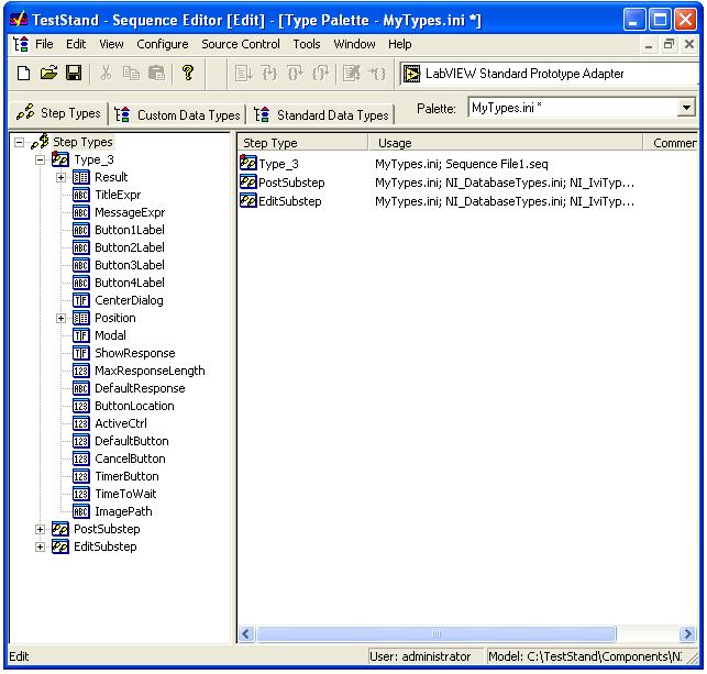

Created custom step type - Does this look right
Combined Message Type with Action Type & addd ImagePath
Inserted the test type in a seq file and specified Two Button Dialog with pic Vi.
I get the popup with the assigned values for buttons title and Message but no picture.
Afterward a runtime error with no details?
What else needs to be done to use it as a custom step?
What role does the Edit Two button Vi play - do i need it ?
