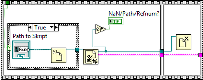

I have a the "Open/Create/Replace File" vi in an executable. It works perfectly fine on my development machine, both in development and in the executable. When I install it on another machine, the <not a refnum>-function returns true.
It seems to me, that the file is not opened properly, even though it exists. There is no error, indicating that there has been a problem opening the file, so I am confused.
Did any of you come across this ... bug(?) and knows what to to about it?
Thanks in advance
This is the concerned code

- "There is no error": well, you don't use the error cluster at all. USE IT! SHOW IT! ANALYZE IT!
- Did you check the path used in the executable? Is the path correct?
Conclusion:
Use error cluster, show a dialog with error number and path in case of an error for debugging purposes!

Now I feel very stupid.
There actually is an error - the file was not found. Smiley Embarassed
I just thought that this error message (file not found) would show automatically if I did nothing to suppress error messages, like wiring an error cluster.
