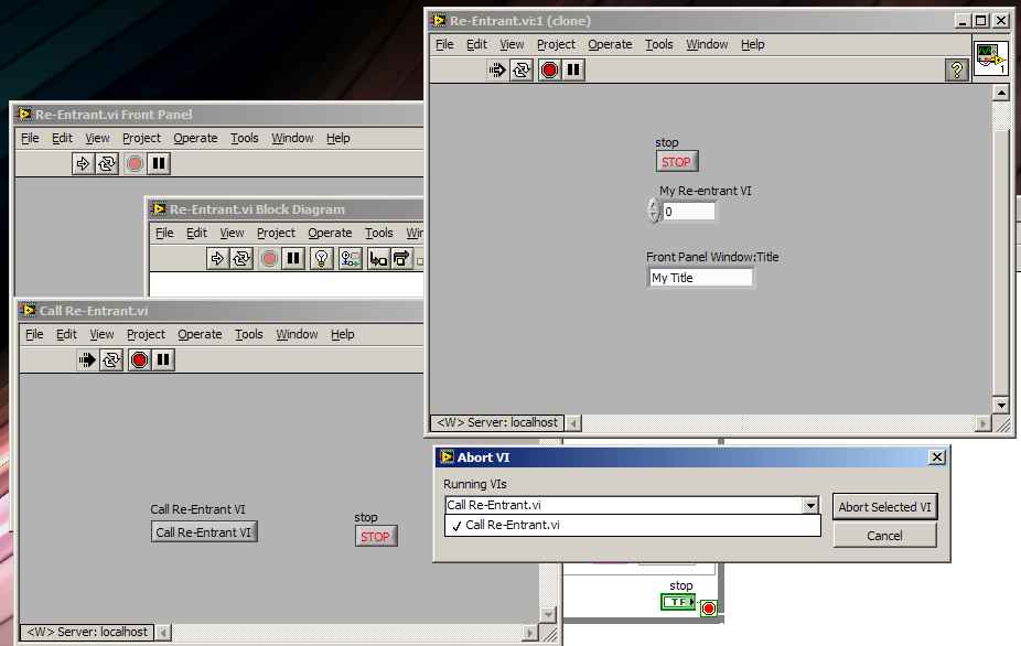

That Abort.vi seems really cool...but it doesn't "see" my Re-Entrant.vi instances 😞 .

Hmmm... That's a shame. Thanks for pointing that out.
It's probably because it uses the Application>>Get All VIs in Memory function to list out all VIs, and then determines which of those are running top-level and can be aborted. The problem is that that function will tell you a reentrant VI is in memory, but doesn't list out which reentrant instances are actually spawned. So you'll see MyReentrantVI.vi in the list, but not MyReentrantVI.vi:1 or MyReentrantVI.vi:2 or whatever. So the dialog can't query these reentrant VI instances to see if they're running top-level and can be aborted.
I only know of a very limited workaround to this problem in LabVIEW, and I doubt it's something that should be used in a general-purpose dialog like this. I'll post my example VI below that allows you to browse all Top-Level VIs running. It's really rough, but might be helpful.
Saved in LV2009. Unzip this and put the VIs in the LabVIEW 2009/Project folder, so that they're available from the Tools menu. This automatically refreshes at a set rate and lists all the top-level VIs running in the current application context, including reentrant instances! For this to work, however, you need to guestimate how many instance might be lurking around so the dialog can look for them correctly. That's what the Reentrant Clone Limit does. For instance, if this limit is set to 3, but your VI is MyReentrantVI.vi:5, it won't be displayed. Alas...
Double click a VI or click the Show FP button to open its front panel, which might help you to abort or stop it.
