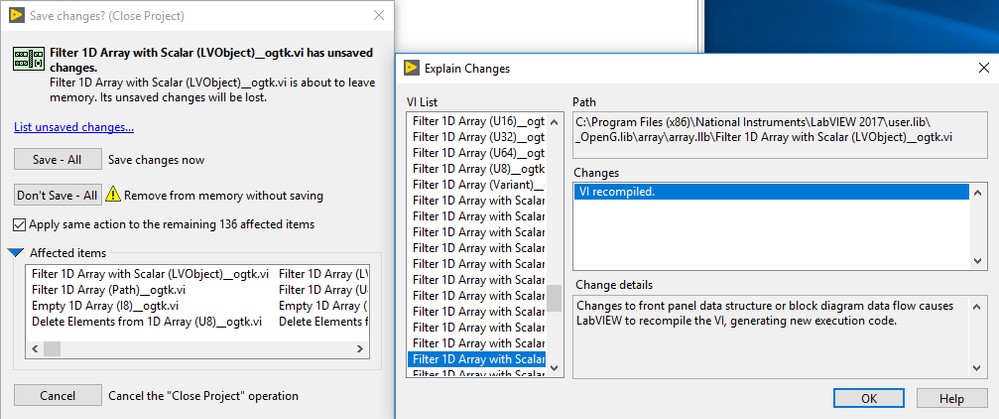

I have a very annoying problem. I am using SVN for version control and have followed the recommendations to separate source from compile code. Whenever I use the OpenG library, however, I keep getting 'changes' on those VIs because they are recompiled. This only happens with the OpenG library VIs, all others are fine. I'm wondering if there is a way to avoid this?

Thanks for the responses. As you can see from my screen grab, the path to the OpenG library is "C:\Program Files (x86)\National Instruments\LabVIEW 2017\user.lib\_OpenG.lib\", which I think is correct. I did not explicitly add the library to my project so I don't know what is triggering the recompile? Likewise, I didn't do any special configuring of SVN. I'll try reinstalling using VIPM and see if that fixes it. Will update if it works.

This doesn't really have anything to do with SVN. The OpenG VIs are not compiled for your current version of LabVIEW, so every time you open one of your VIs that contain them, the OpenG files recompile and your files will show as changed.  I'm guessing you haven't tried doing a Save All when that dialog comes up?

Reinstalling the OpenG package in VIPM seemed to do the trick! I didn't have to uninstall VIPM, just the OpenG package.
Mancho was correct, I don't think this had anything to do with SVN. Seems like the install was corrupted somehow and causing a recompile every time (even if I hit 'Save All'). Everything is back to normal now. Thanks for the help!
