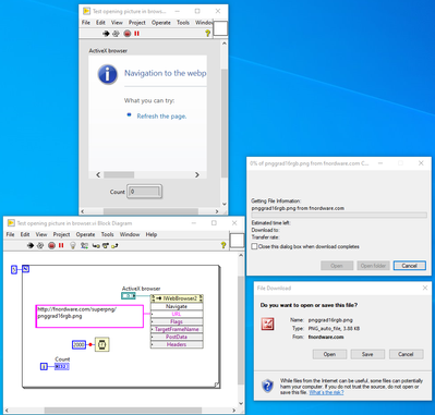

When I use the ActiveX browser in LabVIEW to view an image file, the first iteration always returns a "Navigation to the webpage was canceled" message, and also pops up a window to download/save the image file. The second iteration is then successful. (See the attached example). This is quite annoying.
Is there anything to do with my computer browser setting? (I could open the URL fine on any browser directly, including IE, Firefox and Chrome)
Is there any way to prevent such "first trial failure" and disable the download/save window pop-up?

BTW, the sample PNG file in the VI example I posted above seems no longer working. Here's the screen capture of the problem I'm facing (on some computers only. And as described earlier, this only appears on the first load. It's fine after the second load. But it's still quite annoying):
Thanks in advance for any solution or suggestion.
