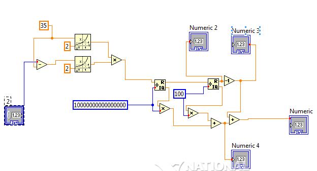

Here is what I got. Very strange bug: Numeric4=Numeric=2^n, when Numeric3 no 0!

Hi nh,
did you read my last post?
You can't handle integers represented by more than 53 bits in a DBL.
Please read this and this, when you don't believe me...
Message 8 of 11
(6,930 Views)

Hi nh,
in your example you're calculating with DBLs which are shown in I64 indicators - and trying to work with >70bit precision.
I don't see any decomposition...
Btw. did you notice all those red coercion dots? Do you know what they are for?
