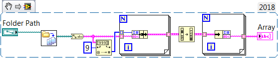

How to sort a (file)list on Another property:
Qestit Systems
Certified-LabVIEW-Developer
