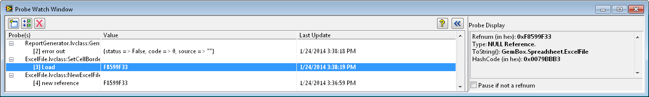

So i figured out something. Its not starting with the Error 2.
So first i create an object.
So this is what i get, Notice the type being an excel file. This is very nice.
Why did my ExcelFile refrence turn NULL?
