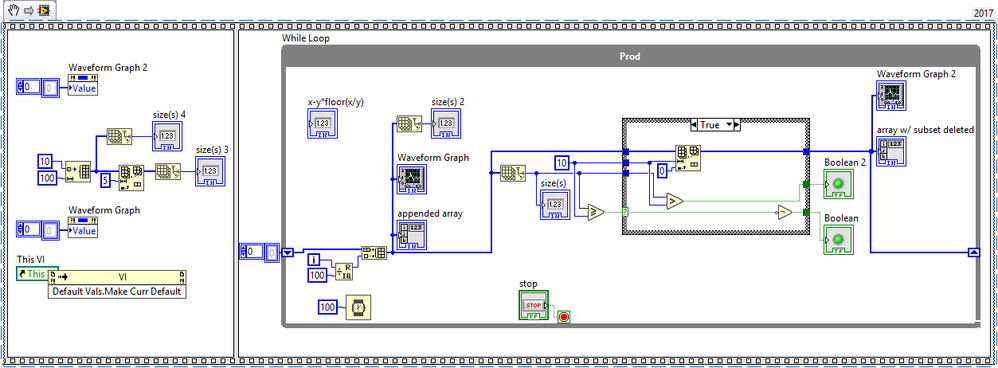

Hello all i have program at attachment.
Here at Cou i supposed to if the size of array equal 10 nothing happened just remove the 10 element.
if the size greater than 10 or less than 10 the Boolean 2 is green all time i don't know why ?
any help please.

For starters, you do not initialize the size of the appended array set in the Producer loop (If you saved this after running it, it may already have more than 10 elements.  Next, even though you reduce the appended array size by 1 in your consumer loop if it is greater than 10 elements, your producer loop is never reduced and will therefore continue to add elements without them ever being removed.  Finally, once it reaches 10 elements, Boolean 2 will always be true.  This is due to the fact that your producer loop is running 10 times faster than your consumer loop (wait delays).  If the initial size was set to 0, then you would see the following for the array size.
0 > 1{False 1}, 2, 3, 4, 5, 6, 7, 8, 9, 10, 11{True 10}, 12, 13, 14, 15, 16, 17, 18, 19, 20, 21{True 20}, 22, 23, 24,...

Accepted by topic author Mohammed_Kandeel
Simple change should stop the overflow.
OutOfMemory.pngOutOfMemory.png/Y

There is really still way too much code.
  • No need to zero the graphs with value property node at the beginning, they'll get rewritten with real data 100 ms later. If this is still a cosmetic issues, go to VI configuration..execution and select "clear indicators when called".
  • It would be much more efficient to operate on a fixed size array of 10 or (100?) element in the shift register. Just replace and rotate as needed (If you would convert to DBL, you could even use NaN for elements that have not been acquired and they won't show on the graphs. Just init the shift register with the fixed size array, delete everything else in the first frame, and then delete the sequence structure completely.
  • The "init all to defaults" is completely pointless for the same reason. The only control is the stop button and that is hopefully latch action so it will be at the default anyway.
