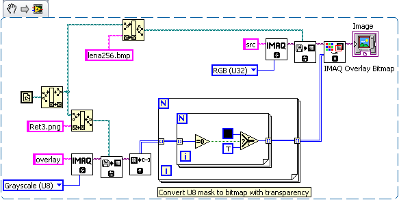

@vascibean wrote:
I have been looking at the overlay VIs, and found one called IMAQ Overlay bitmap - but I think that a bitmap would not have transparency so I would end up with a white square background on the image I'm trying to overlay on my camera feed.
Yes, you can use transparency:
Result:
Andrey.

Hi there,
I've been trying to copy what you've got here but I'm still having a few problems.
Below I have attached an example of one of the images I want to import with transparency. However, when I put that image though the IMAQ VI's it comes out looking something like this.
This is obviously making it come out wrong when I try and merge the images.
Any suggestions that could fix the problem?
I've attached the VI I've been using to try and get it working,
Lou
The following kb should be helpful for you:
Community Admin Note:  The article link has been removed due to invalid information.
Andrey.

Brilliant thank you!
That second link was really useful  - I managed to get my image overlaying properly and I can not get started with getting my images on the camera feed.
The first was also useful, I think I might experiment and see what they look like as .gifs as that might suit my needs better.
Thanks again!
