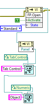

I was trying to understand how to get the owner of a numeric control placed on a Tab control. If I place the control on the front panel the owner is the front panel and I can get the owner with a Front Panel Property node and manage the controls with a Open VI Object, but, when moving the same controls on a Tab and trying to use Tab Control as a owner, the Open VI Object gives me an "object not found" error.owner.png

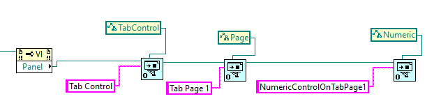

Look for a page as an object within the tab control.
That should lead you to an object on that page.  Or perhaps a container or pane within that page.

Thank you, it works:
