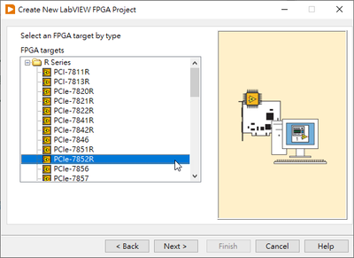

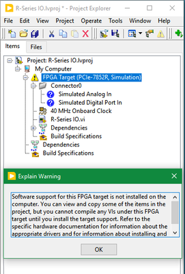

I tried on-line learning project with a simulated PCIe-7852R but got a warn "Software support for this FPGA target is not installed on the computer. ...".
I think I've installed necessary software?

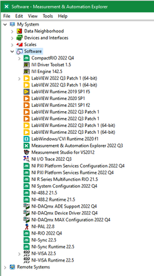

As in my picture R drive is installed and FPGA is activated (works with cRIO FPGA)....

Accepted by topic author C.Gao
But the version for the NI R Series Multifunction Software is 21.5. That is most likely not enough since it can’t know about the existence of LabVIEW 22Q3 and therefore not install support for this hardware into it.

I checked again in NI package manager and now R series software 2022 appeared... I was quite sure that there was only 21.5 yesterday?? Or my memeroy went wrong...
After update, there is still warning but now it is "FPGA Module 64-bit does not support in current target..."
I didn't expect that in year 2023 NI still not fully shifted to 64-bit...

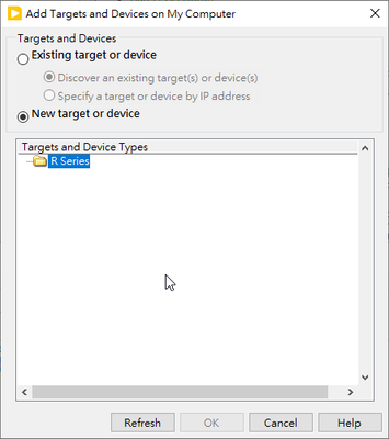

We have a similar problem to yours. We have PCIe-7852R but we can't find any target in FPGA project when we use LV2021(64bit) with R Series Multifunction RIO Driver 21.3 like the below:
But in 32bit is OK....
I also didn't expect that in the year 2023 NI still not entirely shifted to 64-bit.....
Please let us know if you or NI have a solution for the 64bit PCIe-7852R driver, thank you so much~

We have a lot VIs that work in 64bit only, that's why would like to use 64bit FPGA (PID) to work together. A few years ago our engineer help us combine them together and work in 64-bit 2015LV, but I don't know how she did it or what driver she installed on the PC. Anyway, when we update to LV2021, everything goes wrong...

2015 definitely had no 64-bit support for LabVIEW Realtime nor FPGA. So not sure what your engineer did. Most likely she set it up in a way where the FPGA development interface was running in 32-bit and there was some interapplication communication with the 64-bit part of your application.
