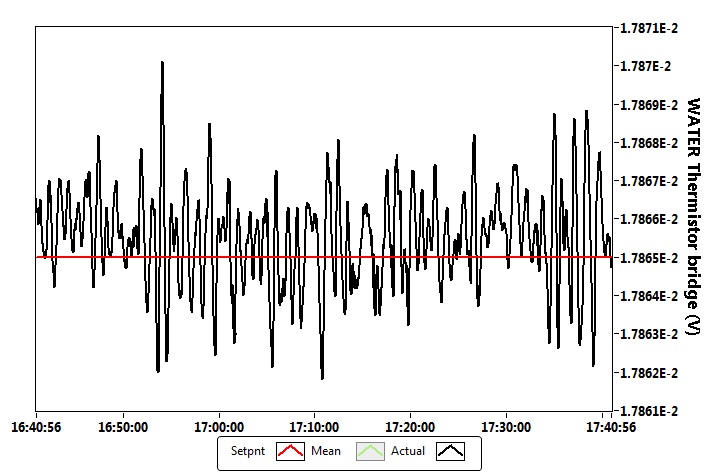

Thank you guys for the help,
actually I reconsidered a few things and I managed to almost totally remove the oscillation. First, since the actual setpoint of this zone was not relevant, only the stability, I have increased the temperature setpoint, to a value where I can use the 100 mA range with using only 1 Keithley sourcemeter.
Secondly, I have taken the PID parameters from the Z-N tuning chart what I have got, and I increased the P value from 83 to 120.
Finally, the oscillation is got depleted a lot. I think I should use a gain-scheduling for the P gain parameter, it looks like the system requires "stronger" gain when it is closer to the setpoint...
