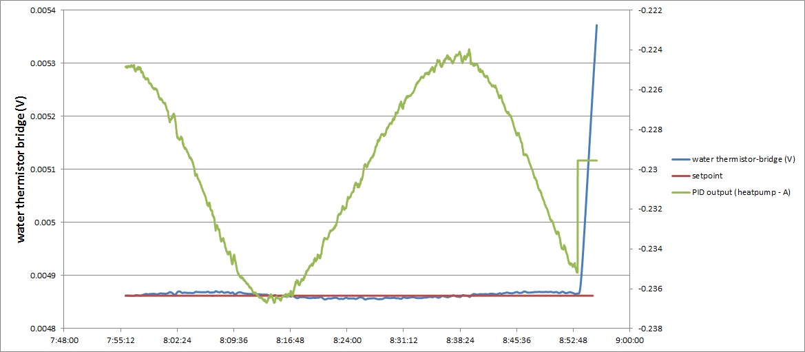

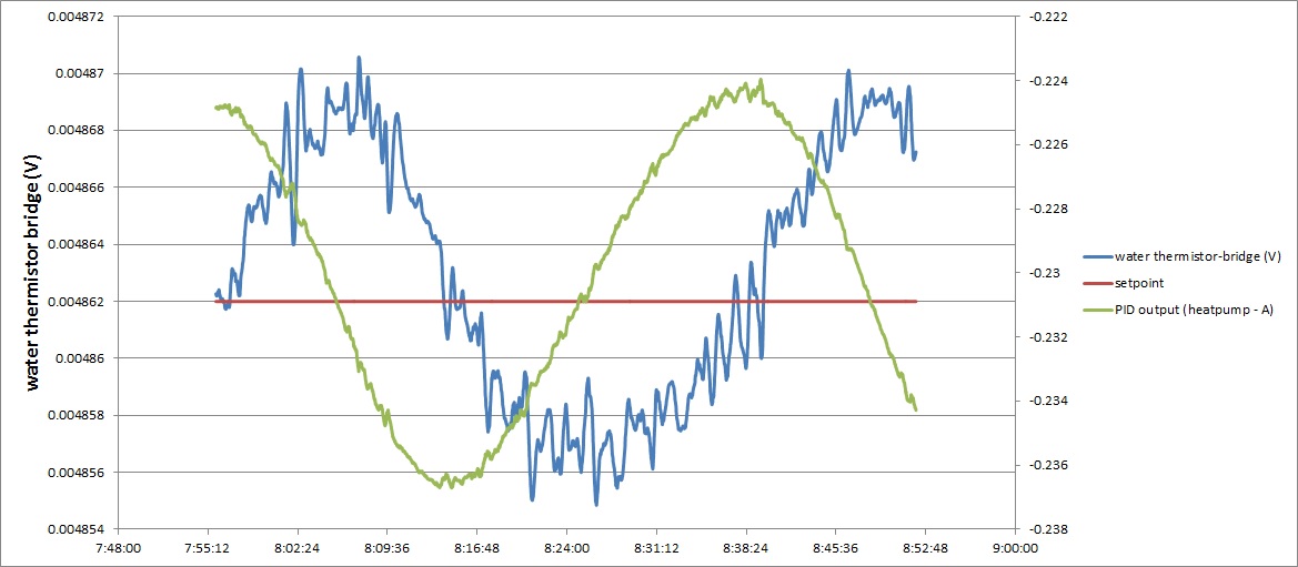

Dear Johnsold,
Here comes the result of the test you asked for:
the quite stable oscillation (i did not disturbe the system overnight):
And the effect of switching the output current to a fix value (average of the last 1 hour):
I have also attached the raw data in an Excel file, in case you need some more close look.

I just want to confirm: in the second graph, the output is held constant and not shown on the graph? The PID output shown is meaningless, since the PID is disconnected? When I rescale that graph to match the upper one, I see the same oscillation. If the output is being held constant and it still oscillates, then it's being generated by something outside the PID loop, and the PID is trying to compensate for it.
Message 28 of 39
(2,081 Views)
hello, the second graph is the same as the first, but contains some additional minutes: where I fix the PID output, and I send this to the current generator.
You can see here, the process value, the temperature starts to run up with...
the green(ish) line is the PID output on both graphs
Message 29 of 39
(2,079 Views)
tomorrow I will try to start this fixed output at the very same time when the recent output has the same value as the average, hopefully the PV change rate will be smaller, and we can see if there is oscillation without the PID control or not....
