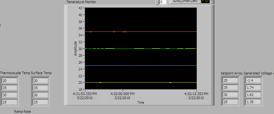

I am having trouble finding the PID values for ramping and sinking for my application.
I have 4 peltier elements that I need to set at diff temperatures. I can get the peltier elements to reach a steady state using the PID vis. I am not a PID expert so I need some advice.
I am displaying both the set point temperature, and aquired teperature in the graph above, so it maybe hard to see the actual temperature line.

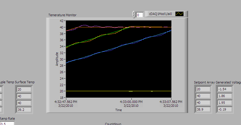

Next is the ramping which I need some tips on for finding the ideal PID. I am using the Setpoint VI found in the PID toolkit for making the ramp setpoints. But with the current PID values, ramping is not smooth.

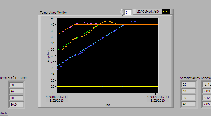

As you can see, it sways and overshoots (not that bad, but for higher ramp rates it's worse). This is at 0.5degree/sec ramp rate. At 1 degree/second, it is worse.
Ramping at 1 degree / sec

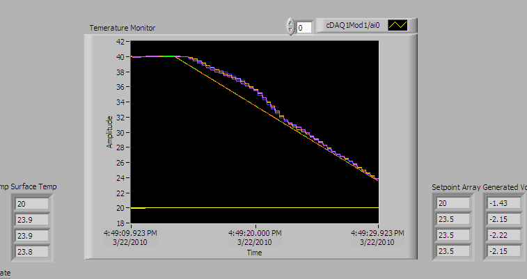

All sinking from 40- 20 degrees at 1 degree/sec
As you can see in the above pic, there is considerable lag, which I am trying to eliminate. Any tips would be helpful.

Your PID controller seems to be working nice in my humble opinion. Its almost impossible for a PID-controller to follow a setpointtrajectory precisely, because its a feedback system. With a feedforward controller its possible to precisly follow your setpoint trajectory, if the outgoing signal doesnt saturate and your model is accurate. You can try to increase your gain or K value of the PID for a faster response aka better setpoint tracking, but its possible you make it more unstable then. The delay can have 2 causes, or you have a time delay in your system, then you are stuck with this delay or the error needs time to build up for the controller to take action, in this case trying to increase your integral action (that is lowering your Ti value) and/or proportional action could help.Having an overshoot usually means your proportional action is to agressive.
