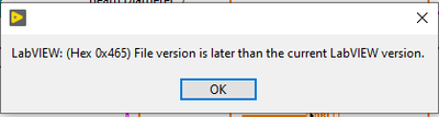

Hi Gerd
What version of LabVIEW did you use?
Message 46 of 65
(2,637 Views)
Hi Andrew,
I used LV2020.
Now I converted to LV2017…

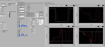

Hi All
Im currently tuning loop 1 and seem to have some success so far. I will proceed with loops 2,3 and 4 and let you know if I run into difficulties. The plots called (loop 2 3 and 4) are showing movements as a result of the mathematics used to produce the voltage outputs.
Fingers crossed that they work as expected now.
