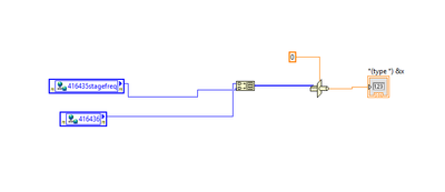

Thanks Rolf and All,
2) The other way is to use 2 adjacent 16-bit register that are interpreted as a single 4-byte floating point number, usually but not necessarily according to the IEEE-754 floating point standard.
I have used this concept wrote the following code and i am getting the data.
Can anyone help to do the opposite of this code, i want to write the Real floating data and want to convert it to
the two 16-bit integer value.
holas
Message 6 of 8
(4,795 Views)
Accepted by topic author Holas1505
Cast the Single value to an array of U16 (or I16).
Paolo
LV 7.1, 2011, 2017, 2019, 2021
Message 7 of 8
(4,766 Views)
There are several ways, including for the conversion to a float.
Rolf Kalbermatter  My Blog
