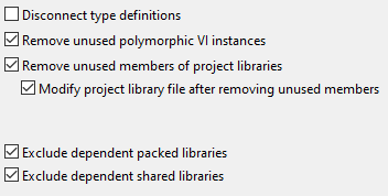

When I tried that I get the error:
Cannot build the application because the following source files are in the destination directory. You must build the application to a different directory from the source files.
I have both all exclude options on:

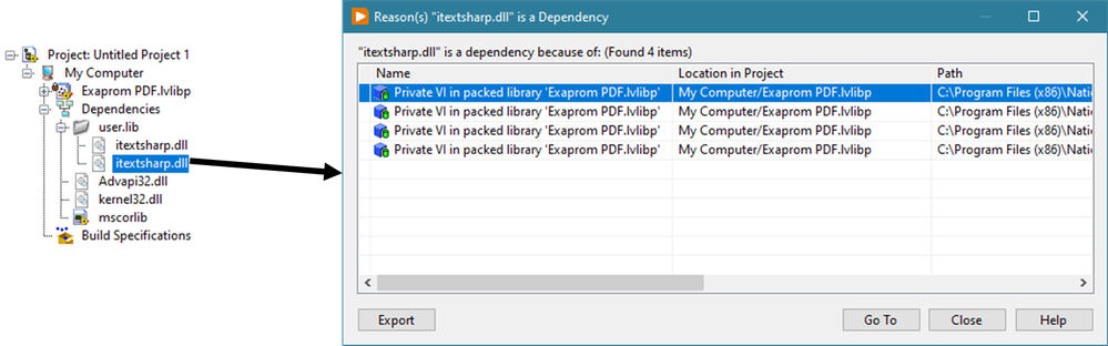

The strange thing is that when I build the PPL like before (with the dependency warning) and add the PPL to a project, itextsharp.dll (the culprit here) appears 2 times in the dependencies list (the original in the source and the one in the build folder).
The one in the source folder shouldn't be there. It is being called by some classes in the library (there are some .net refnum in the their private data). How can I fix this?
