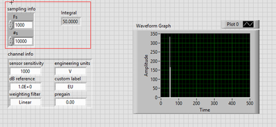

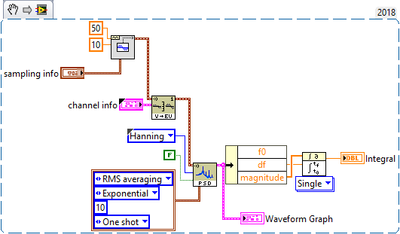

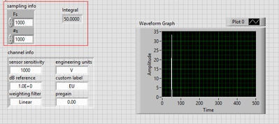

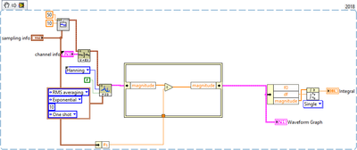

No we tried mcduff's suggestion but it didn't change anything. The problem is not linked to the units of the amplitude but the way it varies depending on the amount of samples of the sine signal.
We have tried using the autocorrelation and FFT VIs instead but we have the same problem (illustrated in the VI attached).
If you have any suggestions we would be very grateful,
Ella

The integral of the PSD should give you the total power in the signal. When you increase the number of points while keeping your sampling the same, you increase your time acquisition. This means the frequency bins are smaller. Thus some peaks will increase, some peaks will decrease, but the integral of the spectrum remains constant.
Different number of points different size bins. If you want the same magnitude for each peak irrespective of number of points, assuming same sampling rate, divide the magnitude by the number of points. To get the correct answer when you integrate you will need to add a scaling factor.
