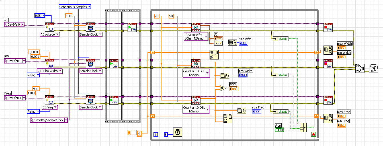

What I'm trying to achieve is as simple as reading a PWM signal and an Analog signal synched using LabVIEW 8.2.
I'm measuring:
 - A PWM signal at about 1050Hz using two counters (one used to measure the exact frequency and the other to measure the width of the high pulse)
 -  Analog Signal between -10V and 10V (from a load cell). I will add another analog signal from the same device in the future, but this is irrelevant.
This is what I've got so far:
20591iD64905BF8238F678
I'm facing mainly one problem with this:
 - Some of my Width and Frequency measurements are wrong. So wrong as extremely tiny width measurements or extremely high frequency measurements (as high as 2500-3000 Hz). I may avoid this by "filtering" the data... But I'm sure I'm doing something wrong and I should be able to get the data OK right from the start.
I guess I'm getting wrong measurements from the counters due to the counter reading "from time to time" getting some of the pulses cutted. I was expecting the counter to read continuosly at the best timebase available with my expected frequency/width and simply discarding the excess of data. For example: at time 0 it will return the first value and at dt it will return the nearest value measured, discarding the inbetween data. So if my rate is 100Hz and my PWM goes as fast as ~1000Hz I will have about 10 PWM measures to chose from for each AI measure.

Now I'm feeling completely stupid. I was relying on the stability of the signal being measured. I've just checked my vi with a pulse train generated from another DAQ device on MAX and it works flawlessly. So problem may be on the signal measured, unfortunately I have no way to check it right now.
Anyway, problem solved...
