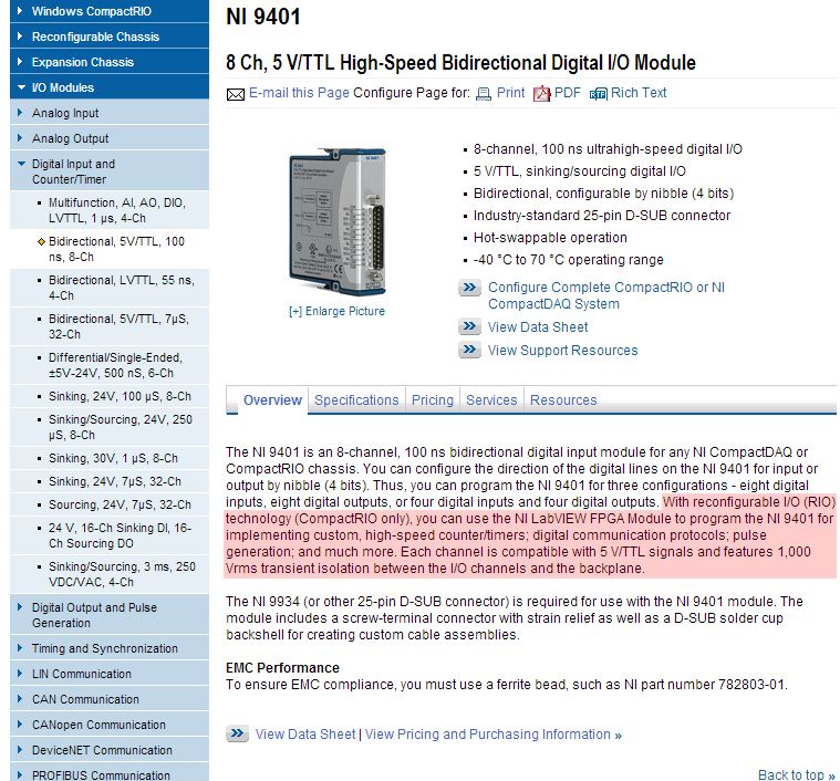

My previous reply I mentioned, 'Specific to RIO', reason being:
NI - 9401
(for reference click here)

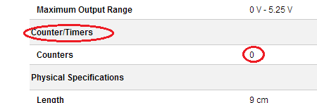

Now the confusing part is, if you check the above link and navigate to the specification tab, you'll see there are no counters available in the device.
NI 9401 - No counters available
On the other hand, when I'm simulating the device, I'm able to see FOUR COUNTERS and TWO PFI LINES.... Smiley Surprised
