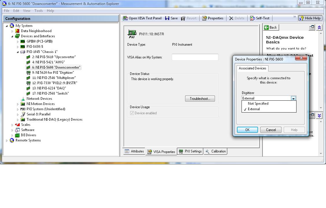

Here is a snapshot of the MAX configuration. Note that the digitizer does not show up in the drop down box when I try to connect it to the downconverter in software.
17801iBA153FCD7767C2F3
Brian Rose

I noticed that the symbol to the left of NI 5620 for PXI Digitizer is different from most of the rest of the equipment listed.  Could this be part of the problem?  It may not be defined correctly.  Every other instrument has PXI in its name.  This one don't.
- tbob
Inventor of the WORM Global
Message 7 of 15
(4,685 Views)
I noticed that too. I figured that I had installed a driver out of order or something, so I reinstalled a bunch of stuff, but I did not have any luck. I even uninstalled the drivers, shut down, removed the card, reinstalled the drivers, shut down again, and then plugged the card back in.
Nothin.

@tbob wrote:
I'm at a loss to explain.  Call NI Tech Support.
I did the same thing last month- you do not need to associate the 5600 with the digitizer
Tech support responded
Hi Jeff,
I just gave you a call back to admit my mental lapse there. Just to re-iterate my phone message, the 5620 and 5600 actually don't get associated in MAX because the 5620 is a legacy device based on our Traditional NI-DAQ driver, which is why using it requires the ni5660 driver and not NI-RFSA.
Setting the digitizer that is used with the 5660 configuration is done using the "Digitizer Resource Name" input of the "ni5660 Initialize.vi"
which should be the first one on the code's block diagram. If that's not there, and we need to look into it a little more, please let me know. You can give me a call back at -redacted- or email me back if my suggestion above doesn't work out. I'll leave this SR open for another few days in case that didn't work out. Let me know how things go. Have a good weekend.
