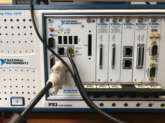

I am using PXI 8133 controller on PXIe-1078 chassis as shown below, with 3 PXIe and 2 PXI cards. PXI Setup.JPG

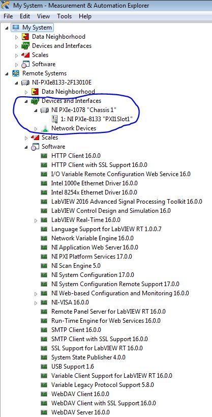

For some reason NI Max only shows PXIe chassis and controller under remote system=> Devices and interface. And doesn't detect rest of the slots. Any help on how to debug this issue or direction is much appreciated.MXI HW.JPG

There was driver version mismatch between my host computer and PXI controller. I fixed this issue by updating NIDaq mx and NI Real Time module on PXI controller.
