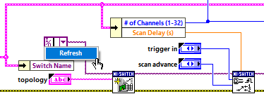

I have a PXIe-1085 chassis connected to my workstation with a PXIe-8388. I have several PXIe-2527 switches that I'm using in a project. They show up in NI MAX as I would expect them to:
However with the default resource name control none of these switches show up.
If I have a DAQ I/O Control Properties: Switch Name then they all show up as listed in NI MAX.
Can anyone help me identify which is the correct control to use? Or how to configure the switches properly so that show up under the default control provided by the niSwitch Initialize With Topology.vi?

Wow, apparently I hadn't updated to NI-SWITCH 17.0.. that fixed it.
