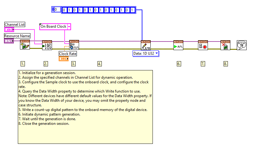

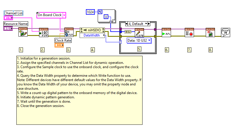

I'm trying to use the module HSDIO PXIe-6544 to generate a clock (square wave) of specified frequency. I found an example in the LabVIEW examples but it is not doing what I want it to do. Can you please help?

I tried adding 0101010101 pattern and it seems to be generating the clock but how do I make the array infinite so the clock runs forever?

I'm not familiar with niHSDIO so I might be wrong.
You can try using the niHSDIO repeat mode in continuous mode to repeat the array.
